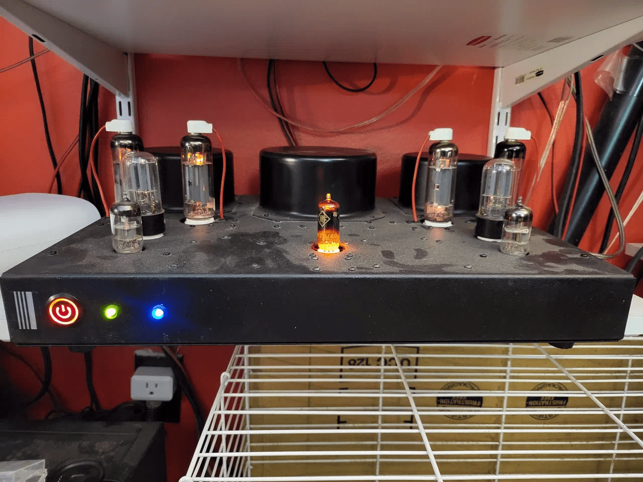

From 6.5V, I'd start with 1k or 2k2... At full current, a blue LED is bright enough to land a plane with! (ok maybe not but it's bright!)

Mine must be GaN. 320µA and it's plenty bright! 1mW of power... The Green one is powered from 12V through 5k1 I think,
