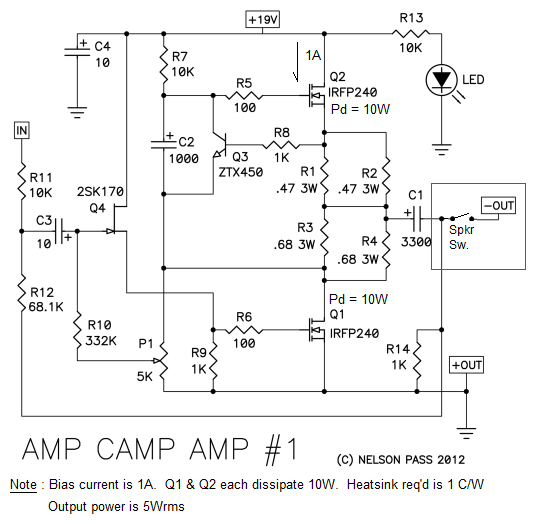

Leave Amp Camp Amp Powered ON or OFF??
I had the same issue at power ON and OFF so I simply added a switch (see red square in the attached file) at the output.
Make sure you turn it off before powering ON or OFF.
Rgds,
Eric
