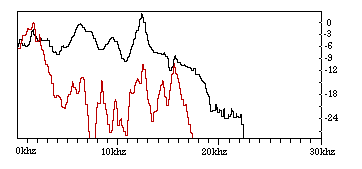

I apologize for complicating the discussion, but using dipoles complicates loudspeaker design and room interaction. Here are just two of many points to consider when designing dipoles. First, while musical instruments (acoustic sort) are not truly omni directional, they do produce sounds that are widely dispersed. A lot of time, effort, and money have been spent to create performance spaces where different musical instruments all sound great, yet most performance spaces are considered inadequate. The number of really great sounding performance spaces is a small number. All sorts of corrections have been tried, ranging from “clouds” suspended from the ceiling to computer based adaptive sound reinforcement systems. Few of the corrections have ever been judged unqualified successes. In addition, simply adding more energy by either increasing the number of instruments playing or changing the direction some of the instruments face does not correct or decrease the number of room modes and anomalies excited. This is not to say that the concept will not work, it is just much more a complex problem with a greater number of variables.
Two, just as the response off the front diaphragm of drivers varies from loudspeaker driver model to loudspeaker driver model, so does the sound coming off the front and back of the diaphragm. The difference in sound generated by the front of the diaphragm and the back of the diaphragm is greater with some drivers than it is with others. This just adds another layer of complexity in driver selection. Rear frequency response is a driver characteristic that is rarely if ever published. When you start mixing the front and a rear sound that are of themselves extremely different at differing delays it becomes an extremely complex design task. I have included the front and rear diaphragm response of a driver that is used by a few members of diyaudio. I have seen threads where this driver is pictured and named. The identity of the driver is not important, but I doubt this is the correct choice for a dipole design.
Best of luck with your designing,
Mark
Yes, however this is a not so much a problem as it seems, in practice. In fact, it is DESIRABLE to have the rear radiation shall roll off, in fact as early as possible above the frequency where the room "transtits" into the "diffuse sound" region out of the "modal region".
Funny. While quite uneven at higher frequencies (where a little absorbent material on the wall behind the speaker such a wall-rug or a large potted plant with small leaves may be on order to absorb the rear wave), the fact that the rear output drops quite evenly and quickly above around 1 - 1.5KHz (hard to see on the graphs frequency scale) makes the driver eminently suitable for a Dipole Speaker that is a dipole at low frequencies and a monopole at high frequencies, just as room acoustics would demand anyway!
So, one would be rather interested in the drivers identity, so one might use it!
Sayonara
