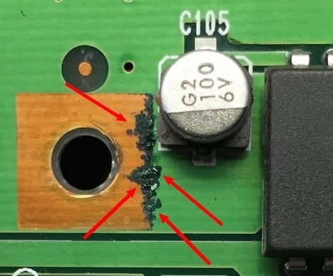

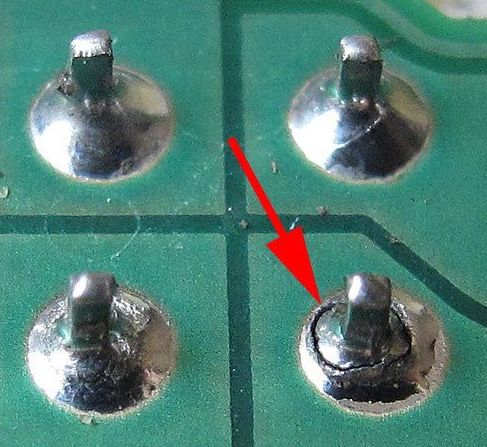

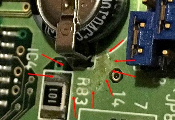

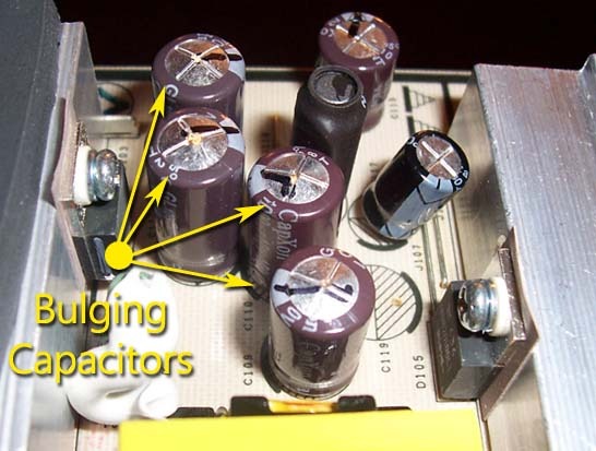

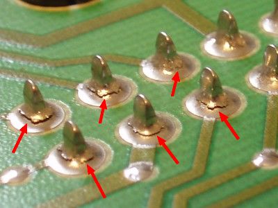

I've been playing around with this long enough that I've learned when something starts misbehaving, I look at caps with the greatest amount of suspicion first. Electrolytic caps, even surface mounted ones, are problematic because they leak their electrolytic fluid. In my experience, anything over the age of 20 is suspect. The other problem that I've identified is solder joints on large-size connections (where a transformer is soldered to a circuit board) or where a row of header pins are soldered to a board are prone to cracking over time. This creates a minute gap that sometimes conducts electricity, other times not.
In either case, visual inspection with a bright light and a hand held magnifier are valuable diagnostic tools. I've revived a great deal of dead electronics simply by recapping a board. Sometimes, it's too late, the bad cap caused a cascade effect and other more challenging problems result. But, in 9 out of 10 cases, I've been able to resurrect a dead device with new caps and/or reflowing large solder joints that are made on the assembly line with "wave soldering" that does not sufficiently fill the gap with solder. See the attached images for things to look for.

Good luck with reviving your Sherwood, Albert. Caps are pretty easy to replace, stick with the same (or very close - within 10%) of the original uF spec and same or higher (never lower) voltage rating. Work slowly and carefully, some mass produced boards are easy to damage by lifting a trace off of the PCB. One interesting thing is that caps can fail without showing outwardly obvious signs. Because the cap "looks" good and you can't see any electrolytic fluid (wet or dried) does NOT mean the cap is trouble free. If it's from the 1980's replace ALL caps.
For reflowing solder joints, check with a bright light and a magnifier. solder joints around caps, resistors, and other small items are likely to be fine. Solder joints for larger/heavier items are most suspect. These are places that typically require a large amount of solder and wave soldering likely didn't get enough solder to form a good mechanical joint.
