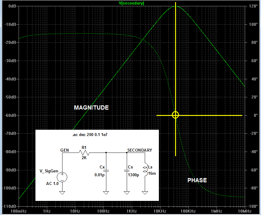

The external series resistor R guarantees that the signal generator always sees a well behaved, easy to drive load. Even at low frequencies, where the inductor is a very low impedance. Even at high frequencies, where the capacitor is a very low impedance. I typically use a 2Kohm, 1/4 watt resistor in this position.
Important note: You want to measure the secondary's leakage inductance, so you need to SHORT the primary. As Hagermann's white paper says, and also as member soundchaser001 says here in this thread.
You can play with the measurement technique in circuit simulation if you wish. Sweep the signal generator frequency and look for the max amplitude (or look for the phase=0 crossover). Do this with different values of Cx. Put the measured resonant frequencies into your equations. Do they yield the correct inductance and capacitance values, which you installed in your simulated circuit?
Protip: If you make Cx really really large, so large you are quite certain that Cx >> Cs, then the two resonant frequencies will be quite far apart, like maybe, f1 > (3 x f2). This will result in less numerical cancellation when you're performing the arithmetic to solve for Ls and Cs. Another way to think about it is: if (Cx >> Cs) then Cs is negligibly small compared to Cx, so (Cx + Cs) = Cx and the measured resonant frequency with known Cx gives you Ls directly. It's one equation in one unknown.

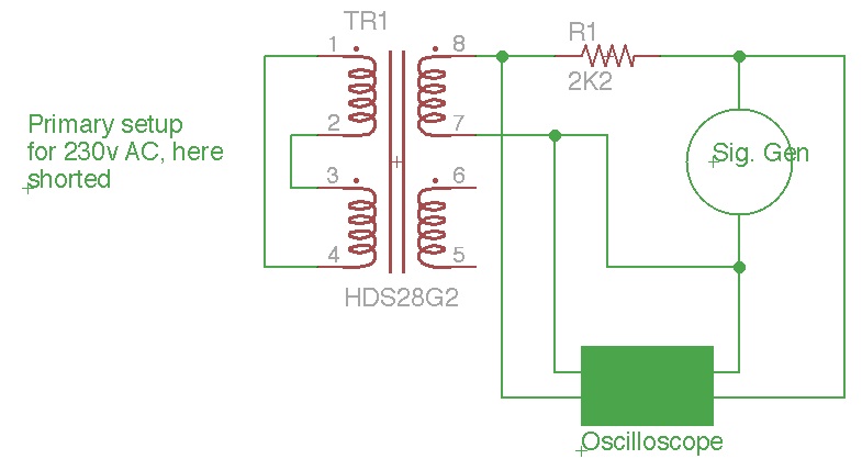

The transformer i want to measure has two primaries and two secondaries.
Both primaries are wired in series for 230v AC, so i would short the other two wires here.
For the secondaries, i would make two measurements one for each winding. I assume that the results of both measurements would be almost identical.

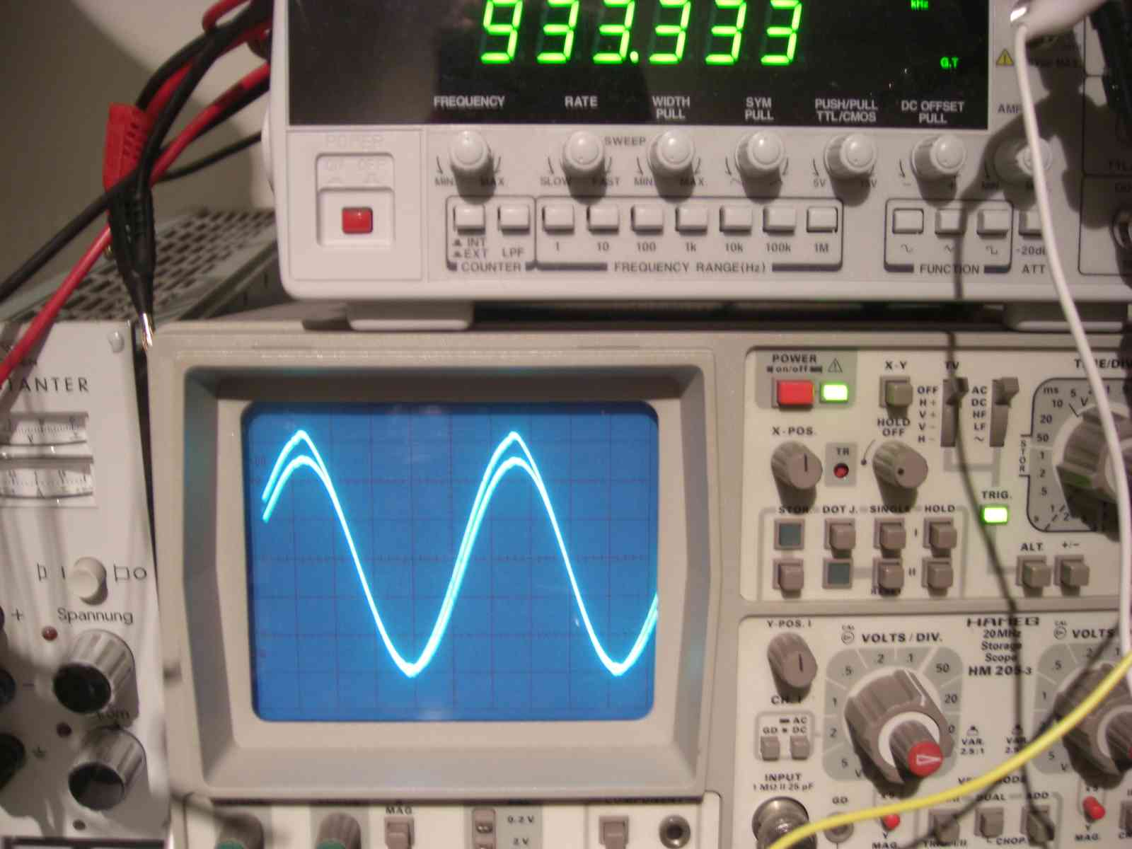

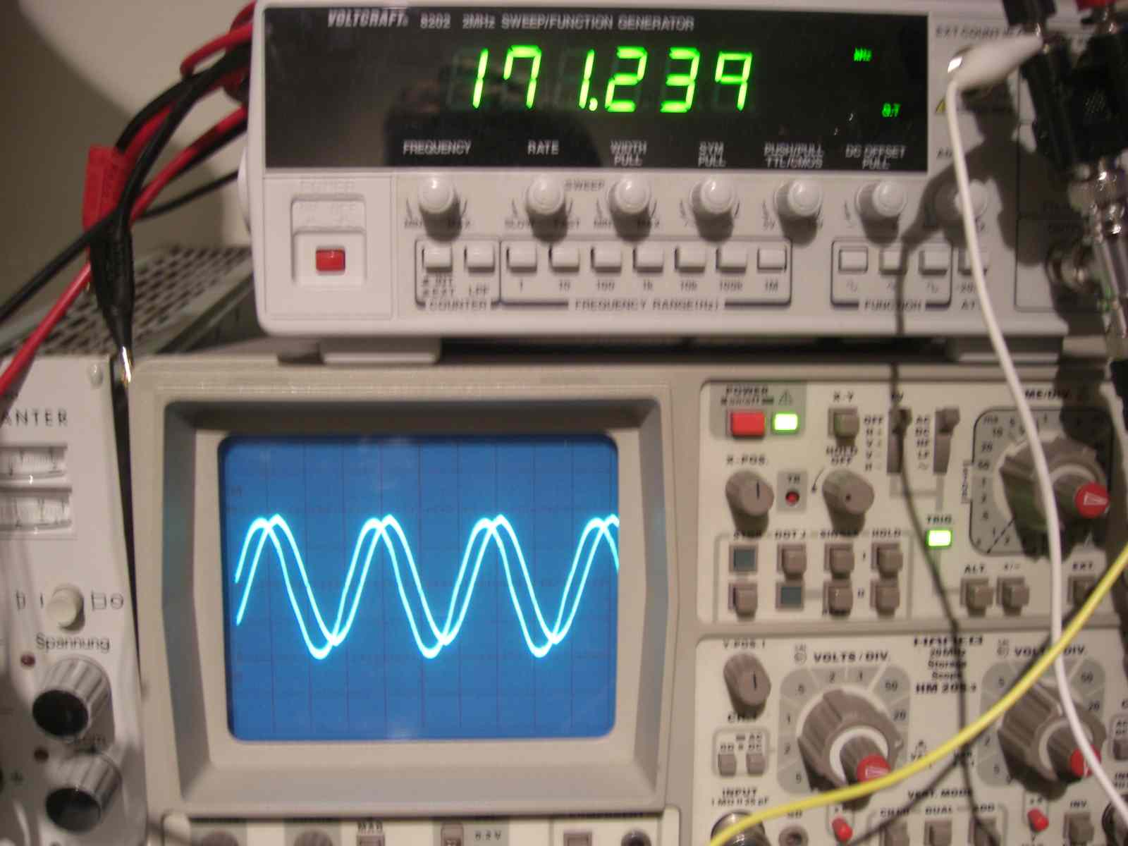

I just performed a first measurment w/o the extra capacitor.
For my testing setup, i fed the signal generator directly into one channel of my oscilloscope and the other into the transformers secondary winding. See first pic.
The basic idea being that the ref signal and the measurement signal align or in phase at the resonant frequency.
Unfortunately this wasn't the case. I could see the amplitude of the meas. signal rise to a maximum at around 172kHz. See second pic.
I found another resonant frequency at around 933kHz. In this case the wave forms aligned as expected. See third pic.
Should i just accept the first measurement or is something wrong here?

Hm, the transformer I measured most recently was an 80 VA model, one of these: http://www.mouser.com/ProductDetail/Triad-Magnetics/VPS36-2200/?qs=1hmqIh58KVntx%2bpne6dXjQ==
and its secondary resonated at 155 kHz (Cx=0) with the primary shorted. So I am inclined to think your 172 kHz measurement is probably the one to trust. Hagerman says (page 5, paragraph 4):
Measure the voltage across the coil while varying frequency. The lowest frequency which gives a peaked reading is probably the natural frequency of the coil.
