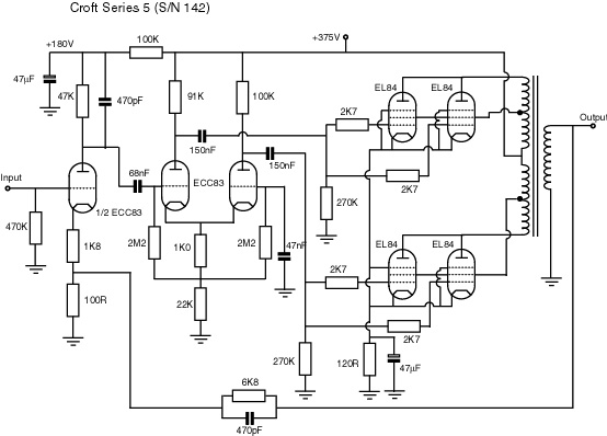

I also have a circuit diagram with Glen Croft's mods of that circuit. In case you're interested I could post it here for you.

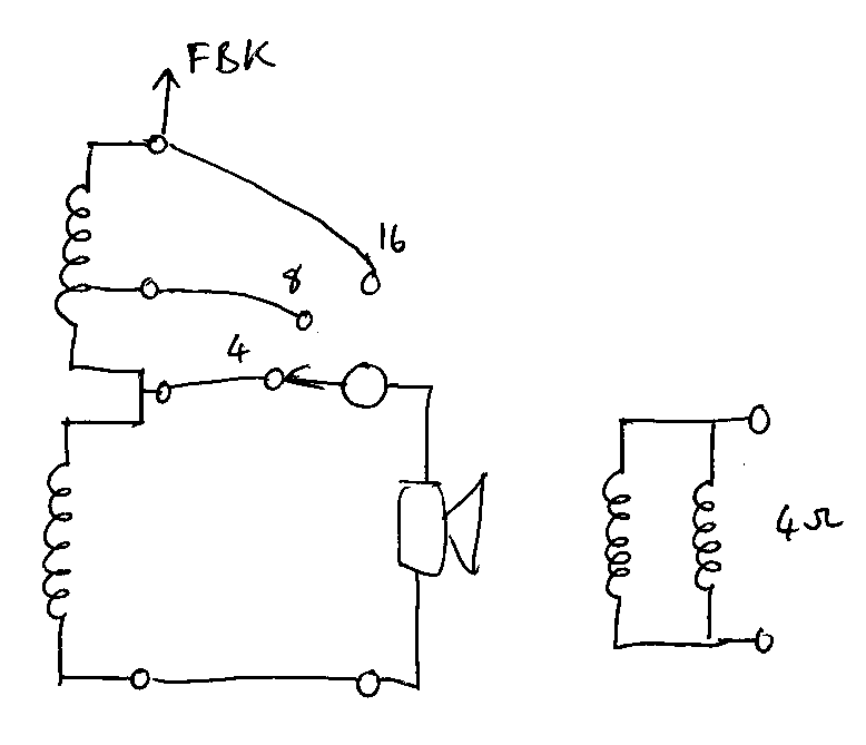

One of the best things you can do with a Leak is to improve the output transformer. Most loudspeakers these days are nearer to 4 Ohm than 8 - especially those using a pair of bass drivers. But if you set a Leak to match to a 4 Ohm load, you only use half of the secondary.
If you have the courage to take the shells off the output transformer, you will find that the individual windings are terminated on cardboard strips glued to the coil. You can then reconnect them as shown in the right hand diagram so that you use both windings - which makes for a transformer with reduced leakage inductance - a better transformer, and it cost only a little time. You will probably go one step further and connect new wires directly to the transformer and throw away the phenolic tagboard at the base of the transformer and its associated old wires.
Having tweaked the secondary, you'll probably look at the primary and see that it's possible to replace the wires there too. The PVC-covered wires solder to little solder tags inside the paper windings, and it's perfectly possible to desolder them and replace them with longer wires that go directly to the valve sockets.
Although it's highly desirable, reducing the gain of a Stereo 20 can't be done easily. You'd probably do better rebuilding it completely with a different driver. A differential pair with CCS might be nice. There was a thread about this recently.
Frank, that would be nice !

I've done so many mods to Stereo 20s I've lost track. EC8010 is right on the button here. The transformer isn't great as it is - I prefer even a 6.6K Maplin one. You have to do something about the power supply. I'd take out the tag board and put in chokes for a start - I use two Maplin ones 10H, 100mA. these actually bolt in directly under the OPTs using the same holes. I've also managed to get all polypropylene PSU caps in there, and I'm looking to add two more chokes, one per side, for the input section. I went over to zero global NFB a while ago and don't regret it. I drilled out the first valve base to take an octal socket and took out the cap the other side to put another octal socket in. I'm not happy with any of the 9 pin input tubes, and I'd rather use 6SN7/6J5 types. I ran 2C22 into 12b4 concertina for a while - that was good. Now I've gone over to a simple 6SN7 diff pair in the input and it sounds just as good. This is the way forward. I have 47K on the anodes of the diff pair, and 500R bypassed with a polypropylene 47uf on the cathode. Not ideal, but sounds good anyway. Anode voltages are surprisingly close. Grid 2 grounded. coupling caps are Russian Teflon - that's not negotiable in my book unless you like exotic paper in oils. Simple 2 stage, no global feedback. Makes the original circuit look positively schizophrenic, and sounds miles better. and now to look at the transformer mods suggested!! Nice post. Andy

Chris has raised some points about the output transformer, and I've been trying to email EC8010 to clarify. The diagram seems to show two windings, joined in the centre where the 4R tap is. I'm presuming that the bottom of winding one (going upwards) is 'start' and that to stay in phase this should be joined to the bottom of winding 2 (upper winding) where it presently joins the 4R tap. The other thing I'm unclear about is that if you parallel the two secondaries, do you still get the same impedence ratio? I wonder if EC8010 could just clarify these details, plus give any indication of benefits in sound quality having done the mod? Andy

Update on the output transformer from the Leak group. There are three output windings. Two are already in parallel. For the third, EC8010 is right. The third winding - looking at EC8010's useful diagram - starts at the 4 ohm tap and goes up to the 15 ohm tap. this winding should be re-connected, the 4 ohm side to negative and the 15 ohm to positive. I hope this is clear. Haven't tried it yet.
