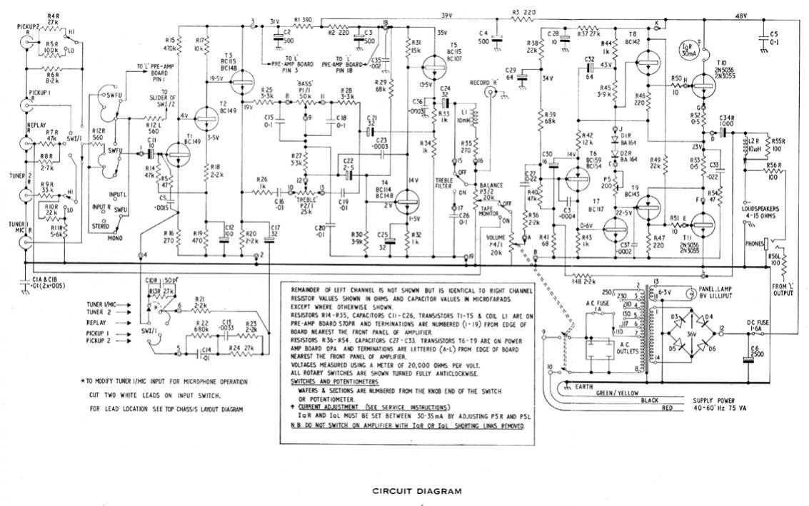

Hi i'm looking to restore a Leak Stereo 30 plus. It has a couple of bad caps in it. So i will just go for replacing the lot. Attached is the wiring diagram
can any of these values be usefully changed to higher values and what would be suggested. I'm thinking mainly of c2 c3 c4 and c6.
Also c34R is a 1000µf electrolytic carrying the audio signal I guess its high to improve signal transmission could this be replaced with a lower value film cap.
any more advice of what i can do would be appreciated

Sometimes you have to be a bit careful with changing cap values as LF instability can creep in, but here you could usefully increase some cap values.
With Early transistor amps the manufacturers frequently used the absolutely minimum values they could get away with as cost was an issue.
C34r (or 34l) definitly does not want to be substituted with a lower value as you will lose all bass. This component if anything could go rather higher, at least 2200uF or even up to 4700uF.
The bootstrap cap C32 could well go up to 220uf.

what would be a good value for C6 with it being the ps smoothing cap i guess it can go quite high? what would a good value for C2,3,4 be? i guess something around the same value?

I've got the copy, the ST120. C34 and C6 are 3300. It will go subsonic, reproducing the thuds of me walking across the floor away from the record player, so I suppose c34 is fine. C6 at 3300 is fine too, it will produce way more than 60 watt/channel until things begin to heat up. If you do increase C6, you might put a NTCR in the transformer input to reduce the surge at turn on. a GE CL-40 or CL-50 maybe. I don't know how tough your transformer is.
C2 & C3, well, the analog C11 on the sT120 is 500 and I put in a 470 when I changed the cap. Sounds fine. Not much current draw on these.
I don't know about the low value film cap on C34. Maybe if you don't like bass. I've auditioned my ST120 with the djoffe bias mod to generate 40 ma idle current on the O.T.'s at all times, and it sounds exactly the same as my capless (in the sound path) CS800s at 1 watt. I use top octave piano as an IM distortion check, against my console Steinway as calibrator. That is on speakers with the 2nd harmonic distortion 30 db down @ 1 W and 3rd harmonic 40 db down.

Ok, C2/3/4 could be 1000Uf.
I would up C22 from 2.5UF to 10uF.
I have often found that C24 can leak a bit putting a bit of DC onto the volume pot (does it crackle?). The value is fine but not available in modern values so a 47uF is a good sub.

Oops, forgot C6. The only possible problem here is can the diodes stand the extra charge current. Most likely yes but you could fit higher rated diodes (3A or more-remember that diode peak ratings are rather higher than average current).
Then you could go up to 10,000uF, the transformer will be perfectly Ok.

The Diodes fitted are BYX36 150 so Vrrm= 150v, Ifsm=30A, If(av)=1A, Vf Max. at if=1.1V, If 1A, Ir max at Vrrm=1µA
I was thinking of changing the diodes at some stage i guess this would work STPS3150RL - STMICROELECTRONICS - SCHOTTKY RECTIFIER 3A | Farnell United Kingdom.

would these diodes work VS-31DQ10 as i have four lying around

Ian, you're quite right, but the OP did ask, and you could agree that 1000uF is rather inadequate given modern speakers which commonly have Z minima 4R or less.
Is it worth restoring this amp and just replacing the existing caps with the same value or as near as i can get except the speaker coupling cap that could be increased to around 2200µf and the PSU cap That could go to 3300µF

Agreed that using the Shottky diodes is rather guilding the lily, but as you have them anyway then you might as well.
2200uF is really a minimum value for the speaker coupler, and as such will work fine, but as you are at it, it might as well be 3300 or 4700.
There is no downside to increasing the PSU cap (but I'm not suggesting doing anything nuts like 22000uF) as it is a bit small so going to 4700,6800 or even 10mF won't harm.
Do the other caps as suggested and it will be fine.
