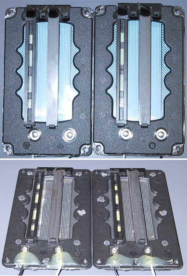

Can you guys ,help me identify what are these(manufacturer, charakteristics), and if they are worth somethig.
Anyway i like the idea of magnets placement, for maybe some DIY twitter...
https://www.kupujemprodajem.com/Leaf-ribbon-srednje-visoki-drajveri-28927872-oglas.htm?filter_id=
Any thoughts on this ???????????? 😕
And i`m trying to get some info on these................ but no luck
https://www.kupujemprodajem.com/riboni-28813312-oglas.htm

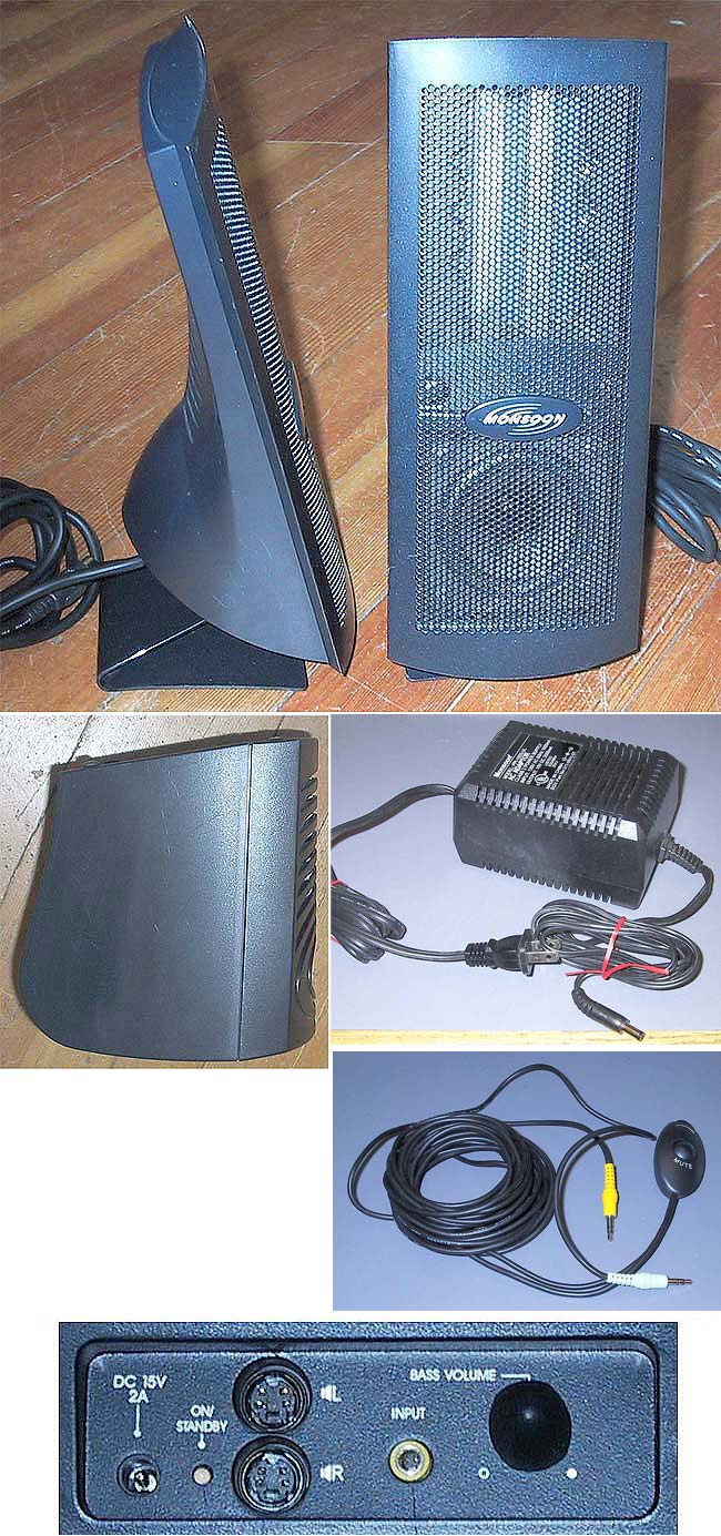

Those are Eastech tweeters made in Malaysia for Monsoon multimedia speakers. Eastech bought Monsoon and then shut it down to get the licence agreement that Monsoon had with Eminent Technology.
They were XOed 2nd order to a 2.5" (and there was a separtely powered mono woofer).
I still have some and could likely estimate the XO.
There are also 2 versions of a larger panel that was used down to about 250 Hz (EQed below the 1kHz dipole rolloff).
dave
THHHAAAAANKKK YYYOOOUUU VERY MUCH ! 😀
Are they worth something (the seller asks for 90 euros)???
And what do you think about the magnet placement for DIY ribbon twitter....
What do you know about the second pair ???
