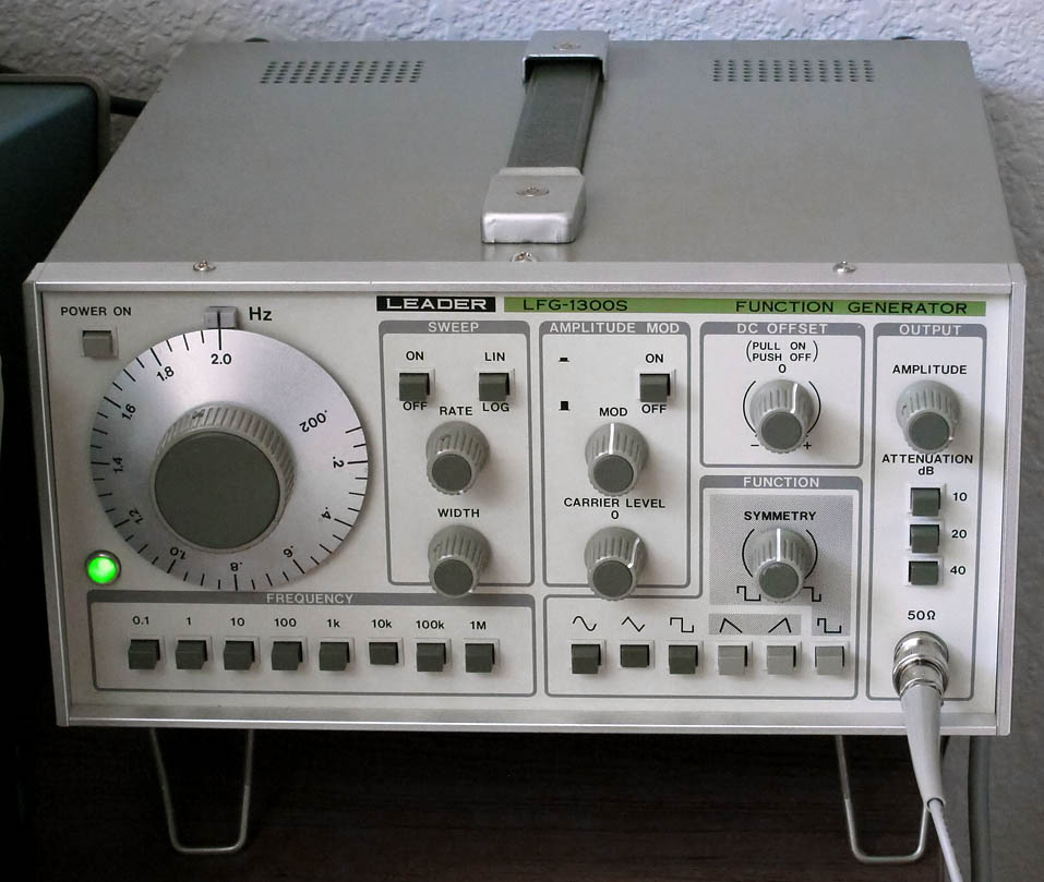

Just wondered whether anyone had come across or played with a LEADER LFG-1300S 0-2Mhz function generator before, or perhaps repaired one ?
I have a 1300S, reliable as you like and a pleasure to use, but switched it on the other day and there was absoloutely no output whatsoever above 100Hz......
Having said that, there is some 'intermittent' output below 100Hz, but it does not tally with the scale readings and is way out-of-range.
It powers up OK, the O/P fuse is fine and all the power supply voltages are spot-on.

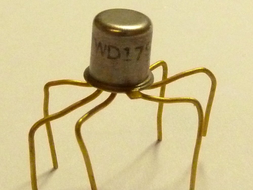

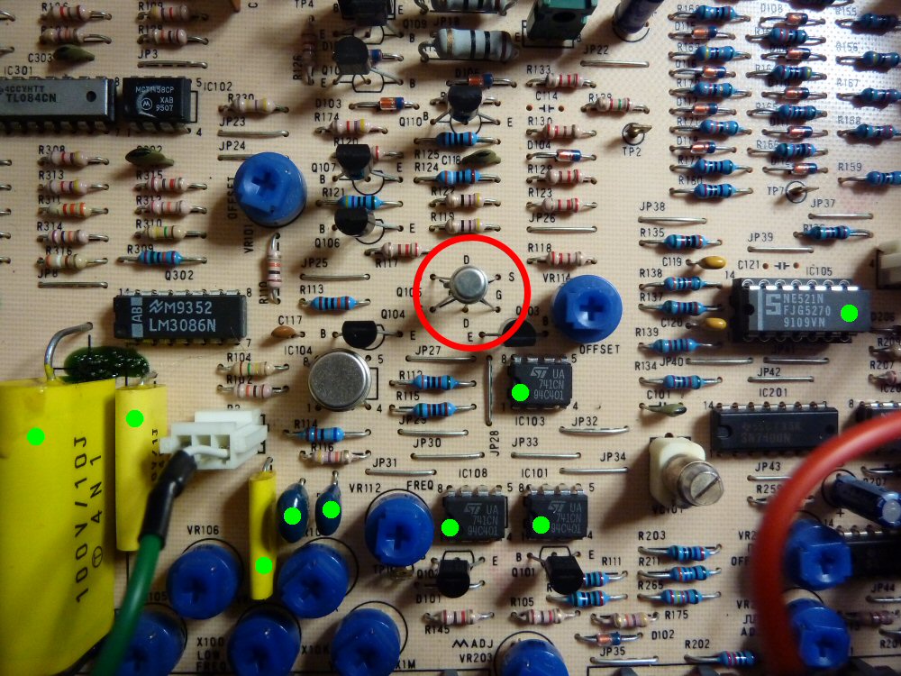

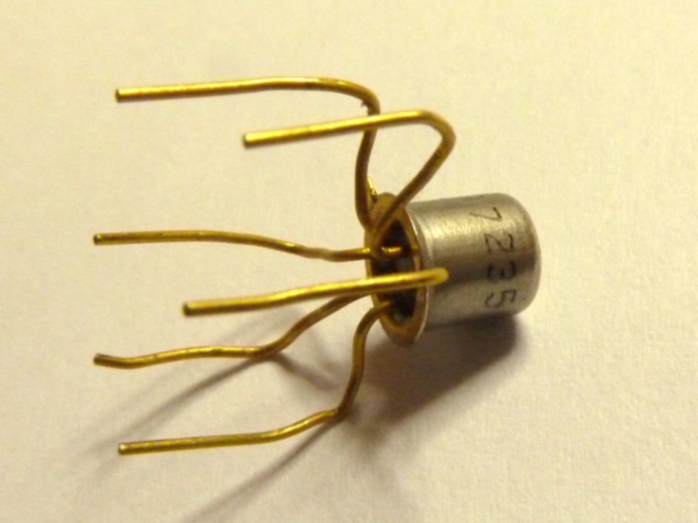

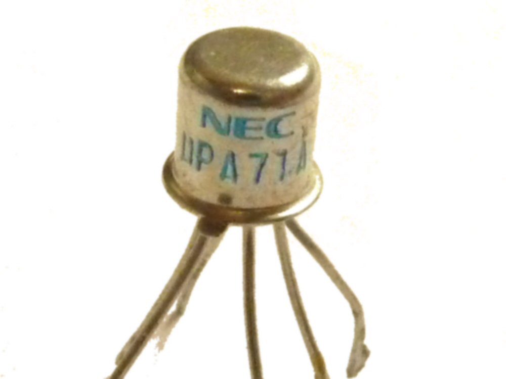

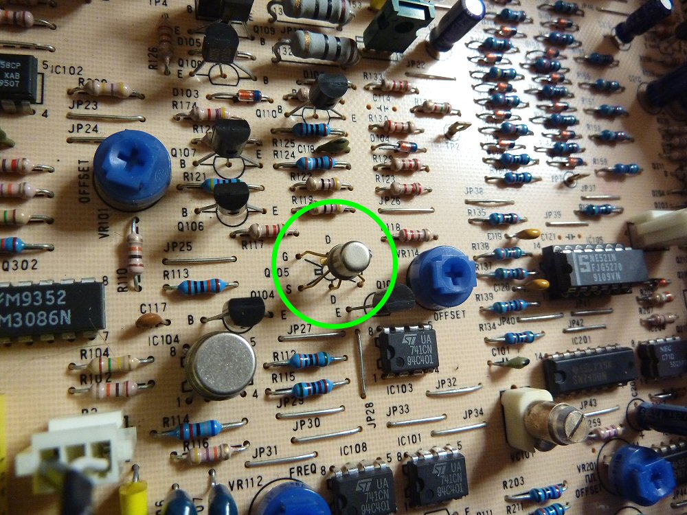

Hello everyone - good news...
I'm pleased to say that I have finally managed to repair the function generator 🙂
It turned out to be a leaky dual-fet (a IMF3898 ), actually partially short-circuit S-D, the upper of the 2 FET's in the circuit diagram, reading around 3200 ohms.
Although an IMF3898 is shown in the parts list for Q105 - a upa71A was originally fitted.
I initially replaced it with a couple of 2N3819's - the generator sprang to life, but would only operate up to approx 800 kHz max.
After routing through my spares, I found what looks like a mil-spec device, a WD179 device manufactured in 1972 - date code 7235. I can find no information on it whatsoever, but it tests as a dual N-channel FET using an ATLAS DCA55 semiconductor analyser.
The generator works fine with it fitted up to 2Mhz, albiet at a very high temperature - ouch....
I need a TO18 heatsink if anyone has one - I just can't seem to get one here in the UK and Digikey want £12.50 for shipping one from the USA, which I simply can't justify, for something that weighs no more than 10grams !!
Below are a few photos : I replaced 4 IC's in total : 3 x 741's & a NE521 (SN75107AN equivilent), not that any of them needed replacing - the 4 timing caps were fine, these and the IC's are marked with green dots in the photos. The dual-fet (the culprit) is outlined in red.
Many thanks for everyone's help in getting this fixed - much apreciated guys 😉

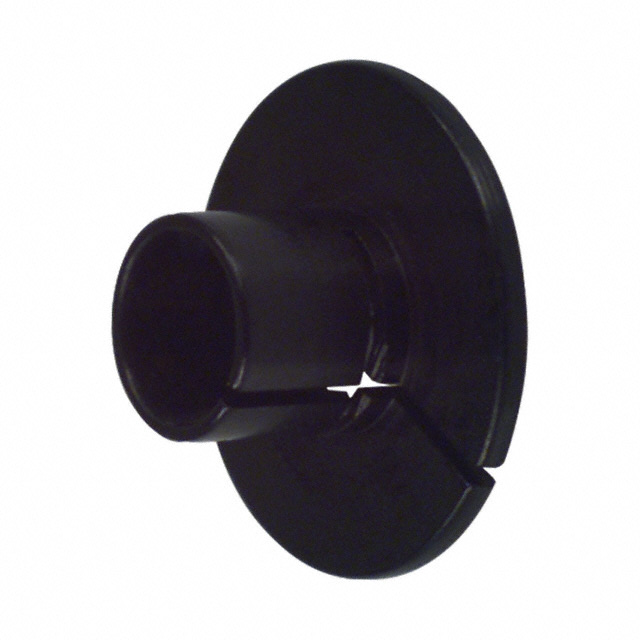

I have a circuit running on a breadboard right now, been running now for 72 hours. I improvised a small heat sink with a strip of aluminum cut from a soda can and held in by an alligator clip. Seems to be working well. It cools a part that used to almost burn my finger to one that is just barely warm. The trick is getting good contact.
I have also seen a brass washer used. If the transisor is in a metal can you can make a washer fit by filing out the central hole or adapt a section of copper tube.

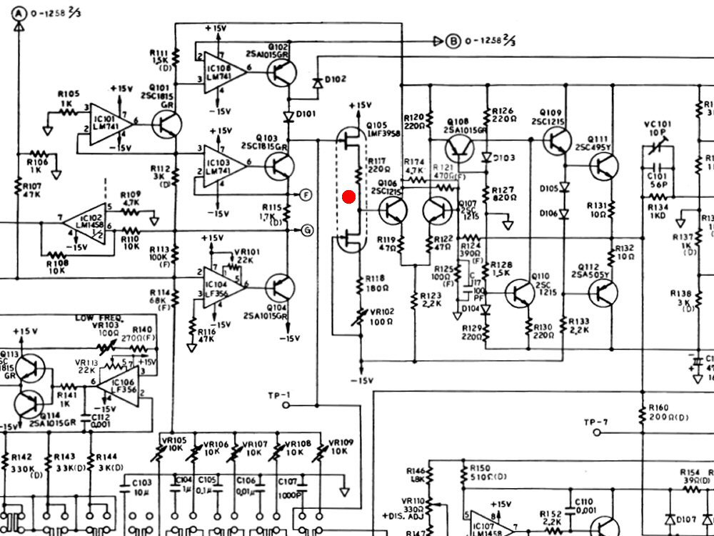

Hi Rich:
Q105 is configured as a follower/buffer. The lower fet is a constant current source.
What if you flip the device and use the section that is not leaky, and use any jfet as a ccs?
Just an idea.
Art

There are a number of listings on eBay for the 2N3958, a direct replacement; also here's a UK source in Surrey.
The dual package was selected for temperature tracking/stability reasons, using separate devices is not recommended.
Richard
Improvise by using a flat aluminum sheet, give it the shape by using a drill bit, and format it to clamp shape by adding an screw and nut.
A bit of thermal paste (CPU coolers) will offer even more perfection.
