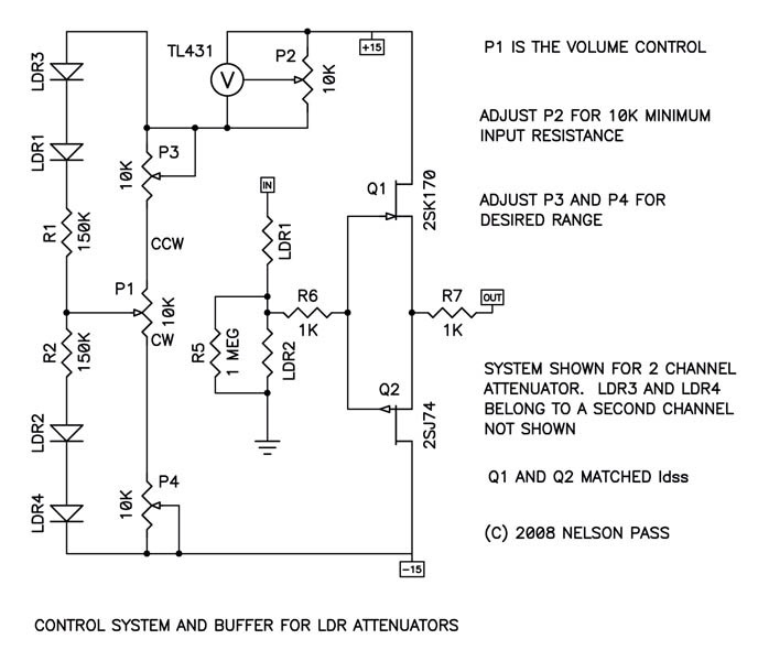

Professional soldering station , amplifiers with triode semiconductors
and bunch of : line stages without global feedback, buffers,
open baffles, full range drivers, horns , high efficiency , autoformers ,
light dependent resistor volume control, Mr. Pass articles and
Burning Amp Festival talks and amplifier kit's for DIY etc etc.
Best regards 🙂
