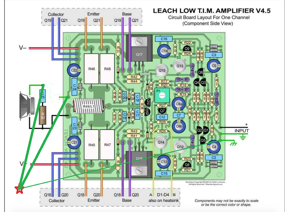

I'm building a Leach Amp version 4.5, and don't know where R51 goes?
R51 is an 82 ohm resistor, shown on the left side of the schematic between Non-Signal Ground and Signal Ground.
If anyone has built one of these amps, can you tell me where R51 is physically located on the amp?
Thanks!

It says that R51 is located between input ground and central ground.
Okay, where? I connect an 82 ohm resistor anywhere between the input ground and central ground?
How do people who have built this amp place R51 into the circuit?

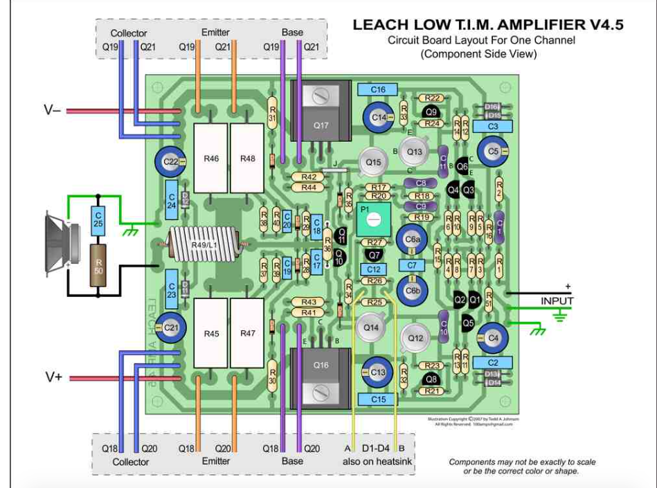

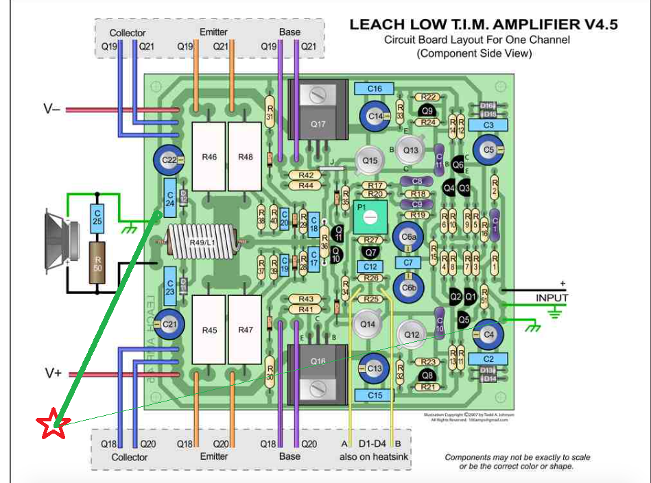

I built my Leach amps according to the original instructions - one thick wire to the "star" and the other thin signal ground wire to the "star" - the R51 is between these two wires on the PCB. Just take into account that the thin signal ground wire is sensitive to interference - it is better to make it shorter and located as far as possible from the transformer...
This can be checked with an oscilloscope, AC millivoltmeter or connect headphones to the output (input must be shorted) - place the wires so that there is no hum in the headphones.
UIt can be done in two ways ( for me 1st one works fine):
