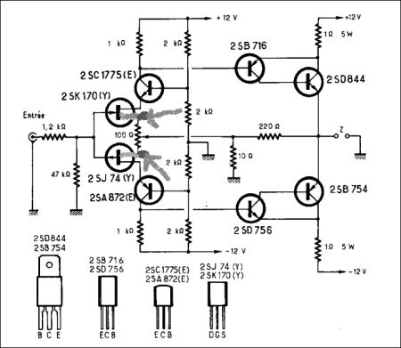

Hi Monstre DIYers,
I want to build two Le Monstre Monoblock's but don't know how to connect the Fet's at the input.
Are the drains connected to the 100 ohm pot or the source?
Or the source from the upper and the Drain of the lower fet or the other way around?
Thanks in advance!
Audiofanatic 😉
P.S. look at the arrows and the dots!
J-fets
2SK170 Fet's drain connect to 1K at + power supply, 2SJ drain to 1K at - power supply.
2sk170 - n channel j-fet. In "normal" mode ( called saturation ) drain is positive respect to gate, and gate is negative respect to source.
Or, drain is positive respect to gate, source is positive respect to gate but less than drain is. Result drain is positive respect to source.
2sj74 p-channel drain is negative vs gate, source is negative vs gate, drain is negative vs source.

This is to make sure that the same voltage drop is seen across each of the 68 ohm resistors to avoid excessive power dissipation across one. :flame: This is so you can use 1/4 resistors for each 68 ohm. If you use 1 watt 68 ohm resistors you can eliminate the 10 K for greater high frequency linearity. If you are going to leave the 10 K resistance in the circuit, use two 20 K one watts with the one end of each returned to the power supply voltages (one negative and one positive) They will look to be in parallel and like 10 K to AC signal voltages. This will improve the PSRR by 12 dB without any penalties except the very modest cost increase for the extra resistor. The 68 ohms can remain 1/4 watts for this approach as well.:treasure:
It lowers the open-loop gain to a more controllable value. The VAS has a current output but the mosfets have a voltage input. Without the resistor the only thing that limits the DC gain is the Early-effect (collector current changes a bit with voltage) of the VAS transistors.
I am not sure how to calculate the open-loop gain on the VAS here (I don't even know how to calculate the bias here, given that we are dealing with th jfet).
so I am not sure how high the gain is here.
A simple question.
What about bootstrapping the two VAS transistors, like in the MOSFET Citation 12? For example, replacing the 10K transistor with a capacitor and put the other end of the capacitor on the output terminal. You will still maintain the DC characteristics of the existing circuitry but the AC gain will increase considerably.
Will this work?
