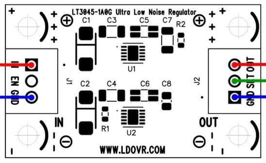

I'm assembling a power supply for my DAC using this LDO in order to replace the original wall adapter that is dead (so the DAC already integrates its regulation).
Upstream I already use a 19v DC source (notebook power supply).
I need to understand if it is suitable to be used as is or if it is necessary to add some bulk capacitance to the output.
These are the already built-in SMD components:
X2 LT3045EMSE
X2 Cap Tant Solid 26uF 25V C CASE 10%
X4 Cap Ceramic 10uF 25V X7R 10%
X2 Cap Ceramic 4.7uF 25V X7R 10%
X2 Res Thick Film 0603 1% 0.1W
The doubt came to me because the same manufacturer sells a more ready-to-use version where you can see two additional capacitors.
If anyone could point me in the right direction, I thank you in advance.

Hi, you won't need added bulk caps but you would need a transformer, rectifier bridge and filter cap (value dependent on drawn current or 4700 µF/A for LDO regs). This assuming the original PSU was a SMPS. You will need a way to transform 115V AC mains voltage to a usable low voltage DC to the LDOVR product. It is therefor an incomplete solution it seems.

Yes you forgot 🙂 Please note that the 19V SMPS may be noisy and riddled with RF. Possibly you will need extra filtering to filter that out a much as possible as even the best regulators let that through.

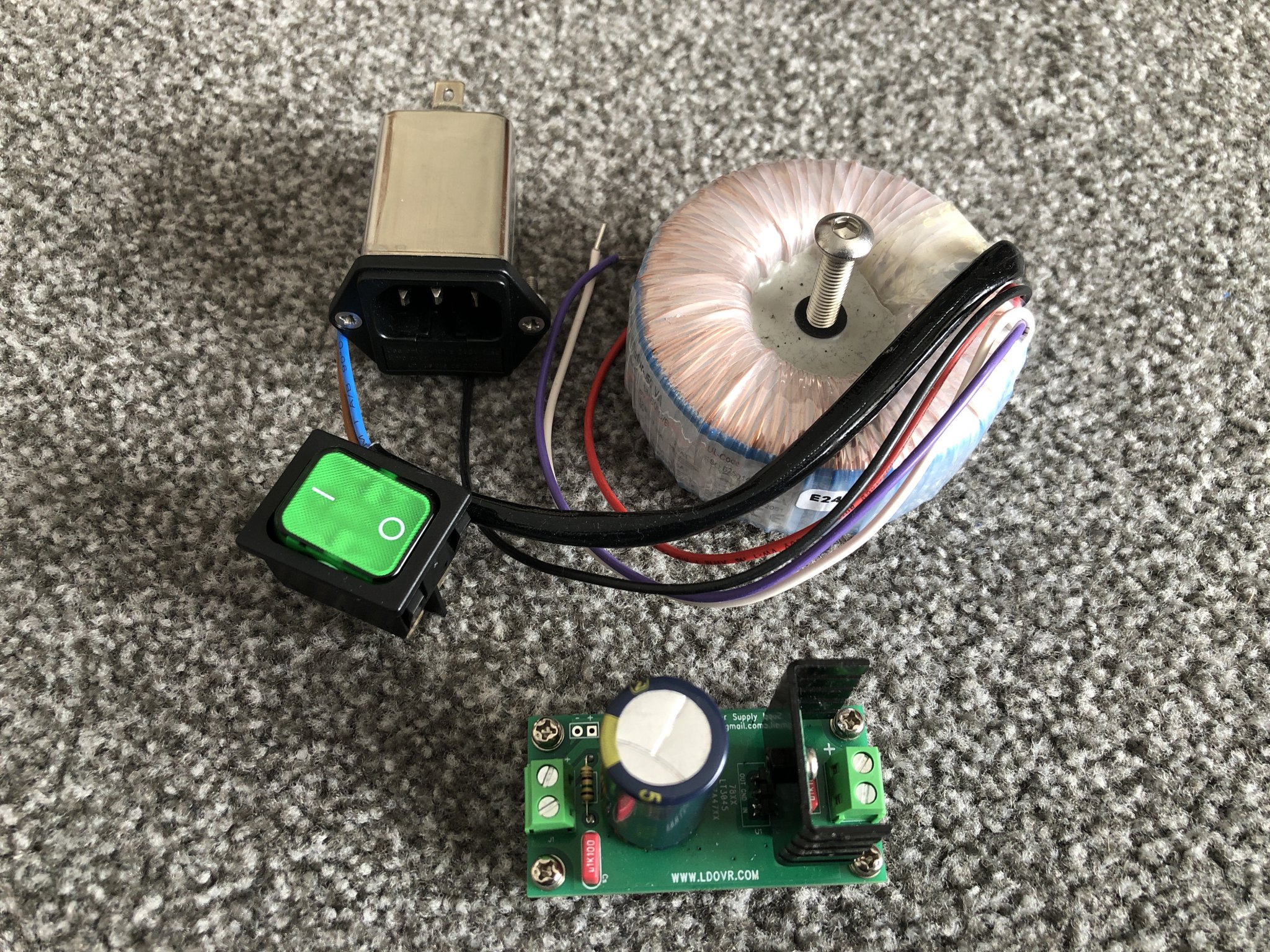

A mains transformer with real mains switch may be safer and have cleaner voltage and it will not pollute mains voltage as much as an SMPS either. Energy consumption also will be 0 when switched off and there will be no risk of fire when you are not at home which are all very nice benefits. You are located in Japan which means you have access to wonderful top class R-Core transformers by Kitamura Kiden! http://kitamura-kiden.co.jp/product/rcore/
Whatever solution you choose, make sure it can handle the current as drawn by that DAC. LT3045 based PSUs have the drawback that their absolute maximum input voltage is close to the SMPS output voltage which may lead to issues when that SMPS overshoots at power on. TPS7A4700 won't have that issue.

No go I think. 12V output is possible. Schottky rectifiers and 4700 uF for 0.25 to 1 Ampère current. For a quality LPS you can use the stuff as pictured with a 15V R-Core transformer. A 2 x 7V (in series) will be better as 15 x 1.41 = 21V. The art is to have headroom and little loss to heat at the same time.
