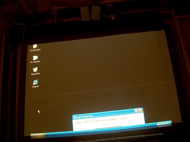

I have an 8" hami and at the top part of the screen (accualy the bottom in the projector) doesnt show Complete black but more of a grey color and also has slightly washed out color. I thought this might be due to too much heat when i was testing it out so i added a fan that directly cools the LCD... I dont know it it is getting worse of if I am just looking to hard.... the lcd is just barly warm to the touch so i dont think it is heat.
Could this be UV or
could it be an artifact of the LCD that I am just noticing.
I am worried about it getting worse and spreading to the rest of the screen....
I have had a UV filter in place the whole time...
is it possible that this could be the result of a wiring issue... FFC not pluged in tightly; although I'd assum that if that was the case the "fadedness" would be very defined
ex. it would cut of at exactly one row/ column pixel
but it seems to be more of a gradual switch. When I get home I'll Try reconnecting the FFC to see if that helps the situation; I'm hopping it isnt perminant but if it is I am able to deal with it as long as i can be assured that it isnt going to get any worse.

Here is a picture (note the top) of the problome.... i am begining to think it could maby an optic issue

the edges of the LCD are masked, but I think the problome is unevidible with this panel; I was looking at other LCD panels And I noticed that even with just the back light certain edges apperead with slightly less contrast. I will try to post more pictures in the near future to try and show the problome in more detail.
heres another picture it isnt accualy that light in the room.... but as u see the top part of the picture has alot less contrast (not as black)...... uhmm Im at a complete loss ...the LCd is infront of both frensels

Could your lcd be not parallel to your fresnel? I have read that the reason why most designs put the fresnels after the lcd is due to artifacts. Maybe your top is getting these combined with a slight hotspot due to not being aligned parallel. Im just guesiing but trying to help.
After considering optics to be an issue i took note that when a white screen is displayed the brightness is very uniform and does not reveal any hot spotting.
Is it at all poisible that the pixles them selfs could have faded some how?
If it isnt that then the only other logical answer would be faulty circuitry....... although like stated before if it was circuitry id expect a specific sharp chang at one point? am i wrong in assuming this
*solid colors generly look uniform across the screen..... tints of solid colors ... ex dark red pronounce the defect
Maybe your reds have started to go. Did you ever overheat that side of the panel? Are all the grounds hooked up like they used to be when it was a regular display? Maybe a too-distant ground could be the problem or noise in the red line???? 😕
