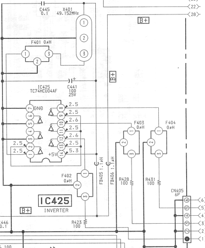

@nForce
When you build the clock of alfsch - be sure to use this 74VHC
type of Hex-Inverter.
I changed my 74HCU04 to this 74VHC04 and sound improves quite
a bit!
I have a 49,15MHz clock in my Sony DAC.
a bit!

>> VHC04
Keep in mind that the xxxxU04 must be used for oscillattors !
See also related VHCU04 on Fairchild :
Since the internal circuit is composed of a single stage inverter, it can be used in analog applications such as crystal oscillators. An input protection circuit ensures that 0V to 7V can be applied to the input pins without regard to the supply voltage. This device can be used to interface 5V to 3V systems and two supply systems such as battery backup. This circuit prevents device destruction due to mismatched supply and input voltages.
and see the VHC pdf file with the gain curve of VHCU04 and the alike level trigger threshold behavior for VHC04!
www.fairchildsemi.com/pf/74/74VHC04.html
www.fairchildsemi.com/pf/74/74VHCU04.html
VHC general : http://www.fairchildsemi.com/ms/MS/MS-521.pdf

Well,
all i can say - when using the 74VHC without "U" i can here the more rlaxed and cleaner
sound (most mids) against the 74HCU without "V". Don´t know how the 74VHCU is sounding.
The fairchild pdf says about the 74VHC without "U"
"The internal circuit is composed of 3 stages including buffer output, which provide high
noise immunity and stable output...."
Maybe this counts also!?

Did you ground the crystal box ? Use also smd caps for the oscillator and block the IC with additional 0.1uF smd cap's!
While overtone is not a very easy task in case not haveing related measurement instruments to measure the phase noise!

It is an existing clock in a Sony SDP90 sound processor DAC.
All i have done is changing the Hex-Inverter.
I can post the shematic later.
