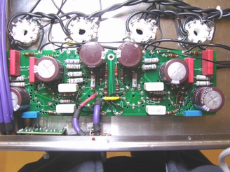

Anyway for anyone like me thinking of doing the mods, here is my findings. After switch on there was an increasing hum, transformer noise and the bias just went through the roof, so much I had to keep turning off the amp, now if you’ve never done this before, like me, you wont know that you cant turn the pots the same way to lower the voltage, as you can see from my pics 2 are clockwise and 2 are counter clockwise, I had to find out the hard way! In the end I removed the valves and dropped the voltage on the pre-sets. I managed to sort the bias but I still had too much noise so I started putting it back to square 1, replacing, removing then checking each stage, if it didn’t improve I left it off. Replacing the feedback helped but I don’t know why, the biggest bug was the short across the 47k underneath, nearly all the other mods have been done in circuit by the manufacturer so they are definitely listening! Other mods they have done is the B+ no longer comes from R13, see pic. If anyone would like the Hi Res versions for cross ref then please msg me.
I would like to hard wire this amp but its too difficult for me at present, there are no ‘R’ or ‘C’ labels on the board and absolutely nothing matches the value printed, my grid stoppers are 1 meg even though it says 560k. I also seem to have 485v at the small tube base’s, I dare not even turn it on now looking at the value of the caps, 315-400 volts. I intend to fit resistors across them all but I fear there may be a problem elsewhere, as you can see from my markings I have removed and measured some of the resistors and the lytics, (one has had a bulge since new and I intend to replace them) but they seem fine. My problem if someone can help apart from the over voltage is how to rewire using as much of the parts as poss, there isn’t a lot of room to re do the power supplies which I see as been the major issue. I would like to keep the cost down as this is a complete learning curve for me, getting decent sound is going to be a bonus! Hopefully we can collate enough info to help anyone like me that wants to have a go but I cannot stress enough that you read this first. Safety Practices, General and Ultra-High Voltage
If you are still awake then here's my pics, good start, can only seem to load 1?

I also recently aquired one of these amps and it works well. I also decided to see if I could improve the sound. I downloaded the images and files from the lampizator site only to find that my amp already appeared to have some of the mods done. There are some odd things about it and the right and left chanels appear different. I decided to proceed with caution and so I just replaced the capacitors (the white ones) with audio grade PIO replacements and I could hear an improvement straight away. I then did the same t the red ones and the sound was not so good. Needless to say, I replaced he red ones. I might try some more of the mods later but need to understand more about what they have done before I start ripping stuff out as suggested on the lampizator site. Interesting though.

Hi friezewood, I found exactly the same but went ahead and did lampys mods, I would recomend you do them 1 at a time and not all at once, I think the circuit may be different because when I put it back together it didnt work very well. I couldnt find anything wrong so I had to take it to someone who knows what they are doing! The guy has 50 years exp with hifi and valves and he does it for a living. I dont feel too bad because he hasnt fixed it yet, he put it all back to how it should be according to the schematic and it still doesnt function correctly. Keep us posted on your mods, I will hopefully be getting mine back soon, I will be taking more time with it!

I did the lampizator mod to my Music Angel... And I think it sounds better now.. 🙂 Anyways, it's much louder, and has more details and clarity and less warmth and muddiness. Let me know if you have any questions.

I recently biased the tubes. But there are 6 trimpots. I turned 2 of them to find out that these were not the ones to bias the tubes 😡
Then, I found the corresponding tubes for the other 4 trimpots.
However I had turned these 2 previously and don't know what they do, where to check the value and which value it should be :-(

After some analysis in the circuit, I found out that these trimpots connet to the KT88s pins 2 and 7 which are the heaters one for each pair of KT88 and paralleled to the 12AU7 and ECC85 one pot per channel. The voltage summs up 6,1Vac. I ajusted them to have around 3,05Vac to the ground on each terminal. I have the feeling that 1 of the power supply transformer is getting much warmer than the other.
I will further analyse the power supply PCB to confirm that these are only for the heaters.
I like the SNR already, but I think that there might be room for improvement on running the heaters with DC. I will probably get 8 LM317 and rewire the heaters.
