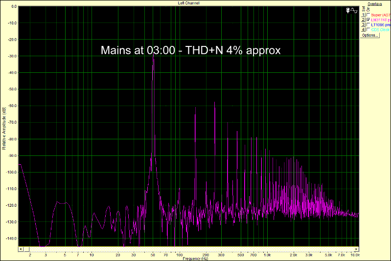

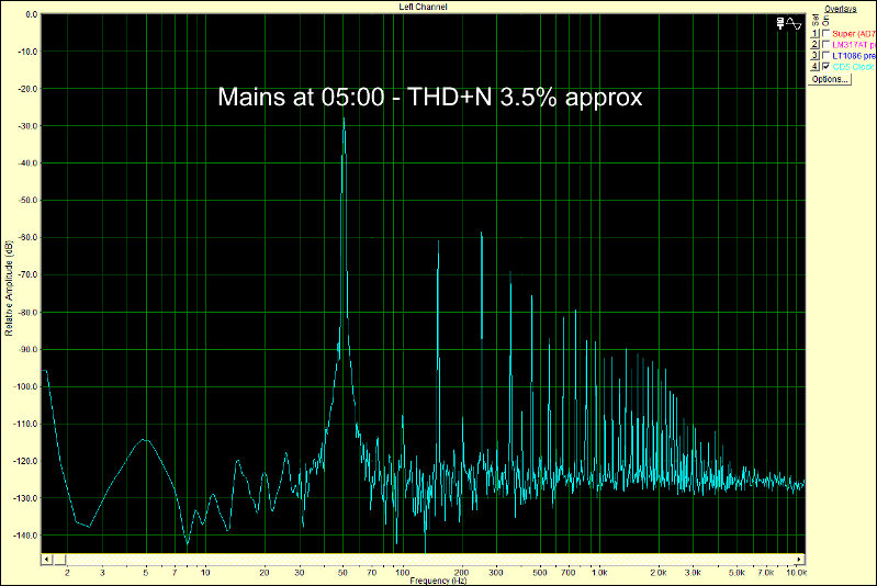

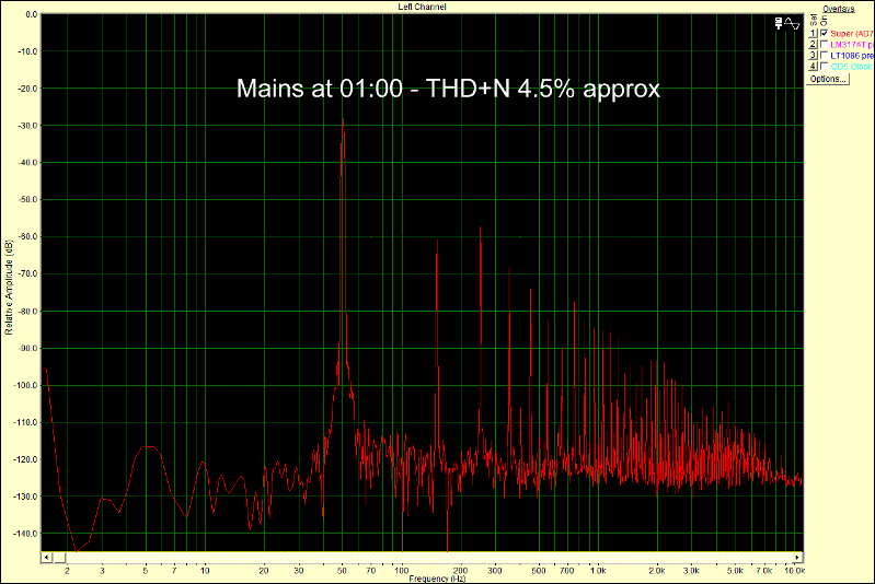

The noise levels present on the incoming mains supply are a candidate, and with this in mind, spurred on by another correspondant I made some interesting measurements using the spectrum analyser.
The measurement system is a simple wall-wart transformer (AC out), and an attenuator on it's output to reduce the mains fundamental to suitable levels. A quick check with a signal generator to ensure it's bandwidth is suitable and off I went.
Initial plots were eye-opening, you may think your mains supply is a nice 50 or 60Hz sine wave (even mine looks good on a 'scope) but there was an extended sea of odd-order harmonics extending right across the audio band.
Could these be part of the reason for the improvements late at night?
I left the PC recording the audio data from the mains overnight, and started to examine a few gigs of data the next evening.

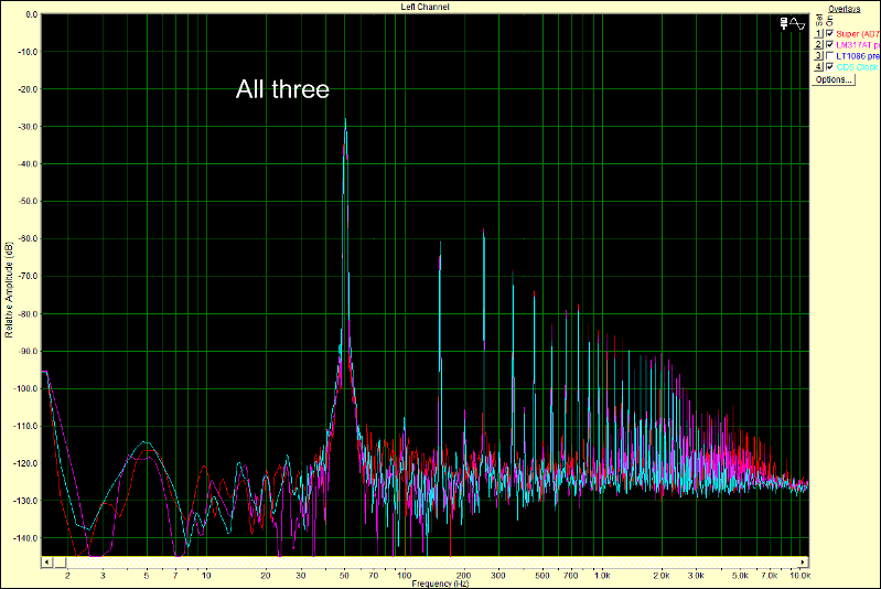

The following FFT plots show what I found, of particular note is that whilst THD does drop later at night / early morning, the harmonic extension reduces considerably, levels at where the ear is most sensitive all but disappear in the early hours of the morning.
With my system, despite almost everything being fed from regulated PSU's with low noise levels and ultra high line rejection there still appears to be a mechanism by which this noise affects sonic performance.
I've also noticed at times during the day, when the system sounds better I can usually correlate this with an improvement in the mains noise levels.
What can be done about this is something I need to apply a lot more thought to, since the easy solution of applying line filters to the mains inlets of the HiFi is a sonically degrading solution that kills the music.

Thanks for the spectra ALW. I'd seen similar done before when I was apprenticing to an engineer and we were trying to trace a noise problem in a system, so we put the specan across the mains and looked, and saw something similar to what you posted. We were in an industrial area with some businesses that ran 24/7, but there was still a reduction at night. There was also a difference between individual phases on the mains with A phase being the worst and C the best. I would expect this to be even more pronounced in a residential area where a majority of homes are wired across the A phase, especially in areas with overhead wires, simply because it's easier to reach the A phase.
The solution to the problem at the time was to use a huge surplus 5kVA isolation transformer and a grid of earth stakes. The bandwidth of the iso trans was only a few hundred Hz, so EVERYTHING above that was attenuated drastically.
Nowadays, I won't build gear with torroidal transformers for the exact same reason: too much bandwidth lets too much junk into the system which is a real hassle to try to filter out. I like first order solutions. Even a huge mains torroid I got recently with an electrostatic strap isn't very effictive at isolation.

I too have noticed the phenomena but this measurement would have been a lot more meaningful to me if it was done on the dc supply rails of the amp and then audio in and out checked for any coupled mains noise. How smooth are the dc rails at different times of the day? If the power supply's properly designed and none of the noise is coupled into the amp anywhere else, then it's just biology and environment. You're winding down at the end of the day, it's dark outside, any background noise is lower, your mind is quieter, there's no other distractions, you can focus better, etc.

The points raised about measuring effects at the output or the preamp power rails are valid and sensible, but flawed in that the assumption made is that the effect of the mains supply noise is obviously measurable.
My low level supplies are all super-reg based, and the inherently massive line rejection and wide bandwidth of these devices means that simple steady-state noise measurements are meaningless. None of the mains supply noise gets through to the power rails, yet I can make changes to the raw supply (different caps, transformers or filters etc.) and the sonic effects to the unit being powered are obvious.
Adding for example a line filter ruins the sound, yet the mains noise drops when using one, and the output of the regulator looks unchanged!
I'm not saying it's unmeasurable, but more that I don't know what to measure.
As an engineer I find this stuff fascinating, I always want to understand and be able to measure the effect I'm obviously hearing, yet have often been unable to do so.
Measuring power amps rails is pointless, they all look much noisier than the incoming mains, owing to the high levels of harmonic generation through narrow conduction angles.
