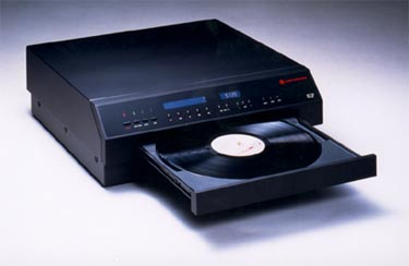

Hi there guys,
I was curious to find out whats the difference between the laser and needle turntables? Does anyone own the laser player?whats the difference in sound quality? I was inclined in buying a turtable and came across this laser TT. I thought you experts would know better than me as I am new to this vinyl but certainly immpressed with the quality of sound with the TT's.
here's the link www.high-endaudio.com/RC-ELP.html
Thanx.
Tony

The laser turntable should be the best but I've read that they suffer from record surface noise. The laser cannot push dust out of the way like a physical stylus can.
I'd prefer a laser pickup as there would be zero record wear and there would be no penalty in record life if you played the same track more than once times in a row in the same day.

The key point is that vinyl (also lacquer) is a deformable material, and LPs have been mastered to sound "right" when the groove has been deformed by the localized pressure of a stylus. Remove the localized pressure, and you are listening to something other than the playback conditions that the cutting engineer mastered the LP for.
Not necessarily bad, but certainly different.

Optical reading of analog discs is the technology of the future, and always will be.
Some of you older guys will remember Finial.
Im an older guy (Well a little bit older) and I cant see this as sounding BETTER than a traditional needle..... To me laser IS DIGITAL and not as good sound...
I would not want one of these!!
