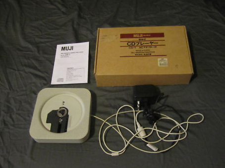

I also remember seeing this, which is all over the web. It doesn't have anything in the way of stopping you not putting the cd in and playing and therefore activating the laser from what I can see. Is it safe? Not an area of expertise as the only stuff I know about laser etc is what is in a A-level. And rather be safe than sorry.
link: Make a Muji Wall Mounted CD Player | VVANK

A link to a real 'open' cd player by a real company. So how do they go about it? Is there a microswitch that the cd presses on to tell it it has a disc in and a little rubber wheel on the end for when the disc is spinning?
Edit: I have found a image of the Muji with no disc. If you look closely at the other side to the actual laser, it looks like it must have some sort of other 'laser' to tell it a disc is in.
Probably just an IR led and photodiode, not another laser.

Hello Joe58
Known the fact that I do a lot of repair bussiness on CD-players and I can still read this threat, the laser will not do any harm to your eyes. The numerical aperture of the objective is about 45, so the laserbeam is very divergent.
Without a disc on the turntable, the laser cuts out after focussing so again no danger.
Make sure you use a proper clamp to keep the disc on!! Otherwise it behaves like a frisbee.
The things you see on the side of the laser on the photo are the laser- and photodiodes. It is a so called flat optical pick-up.
