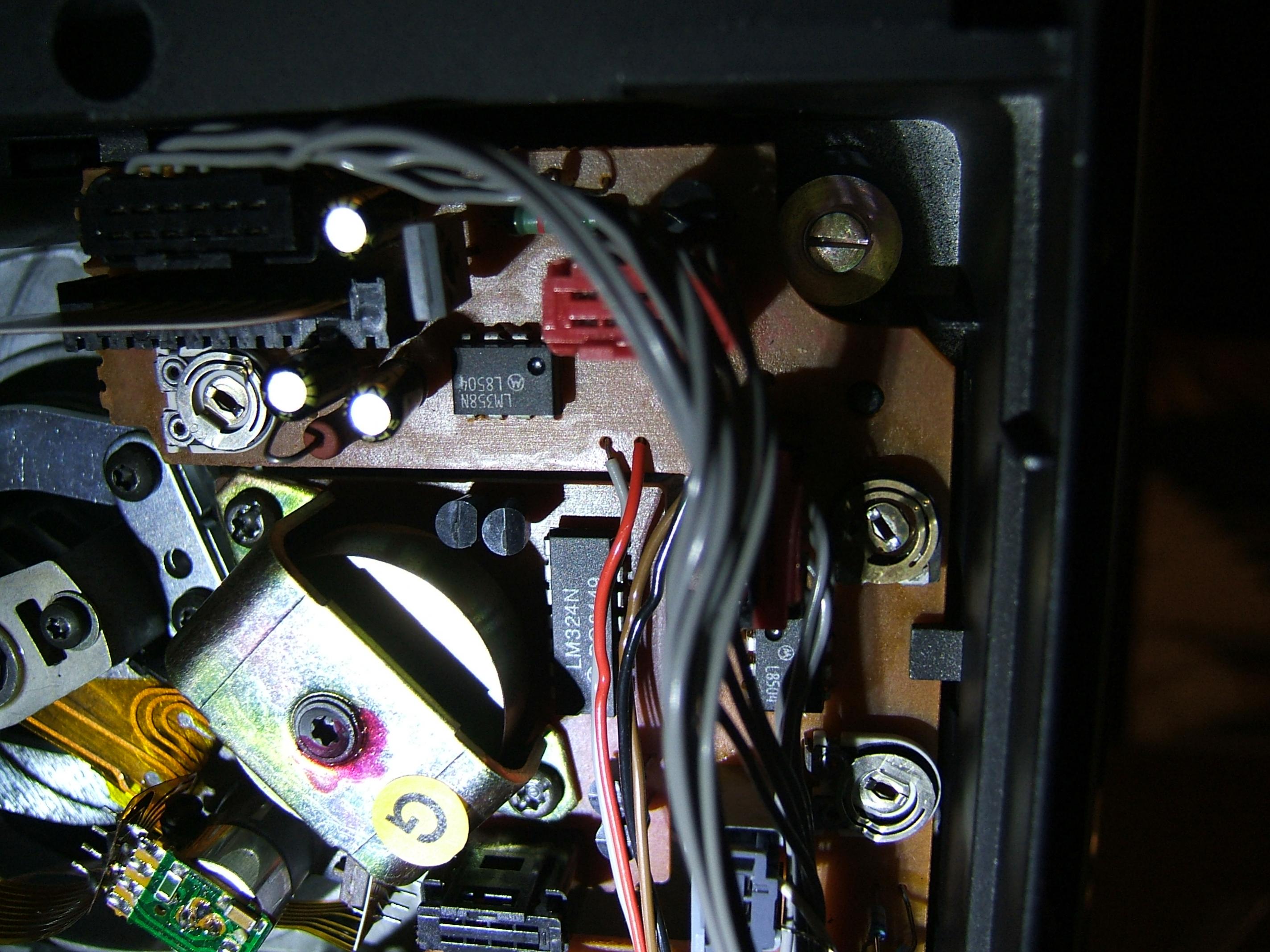

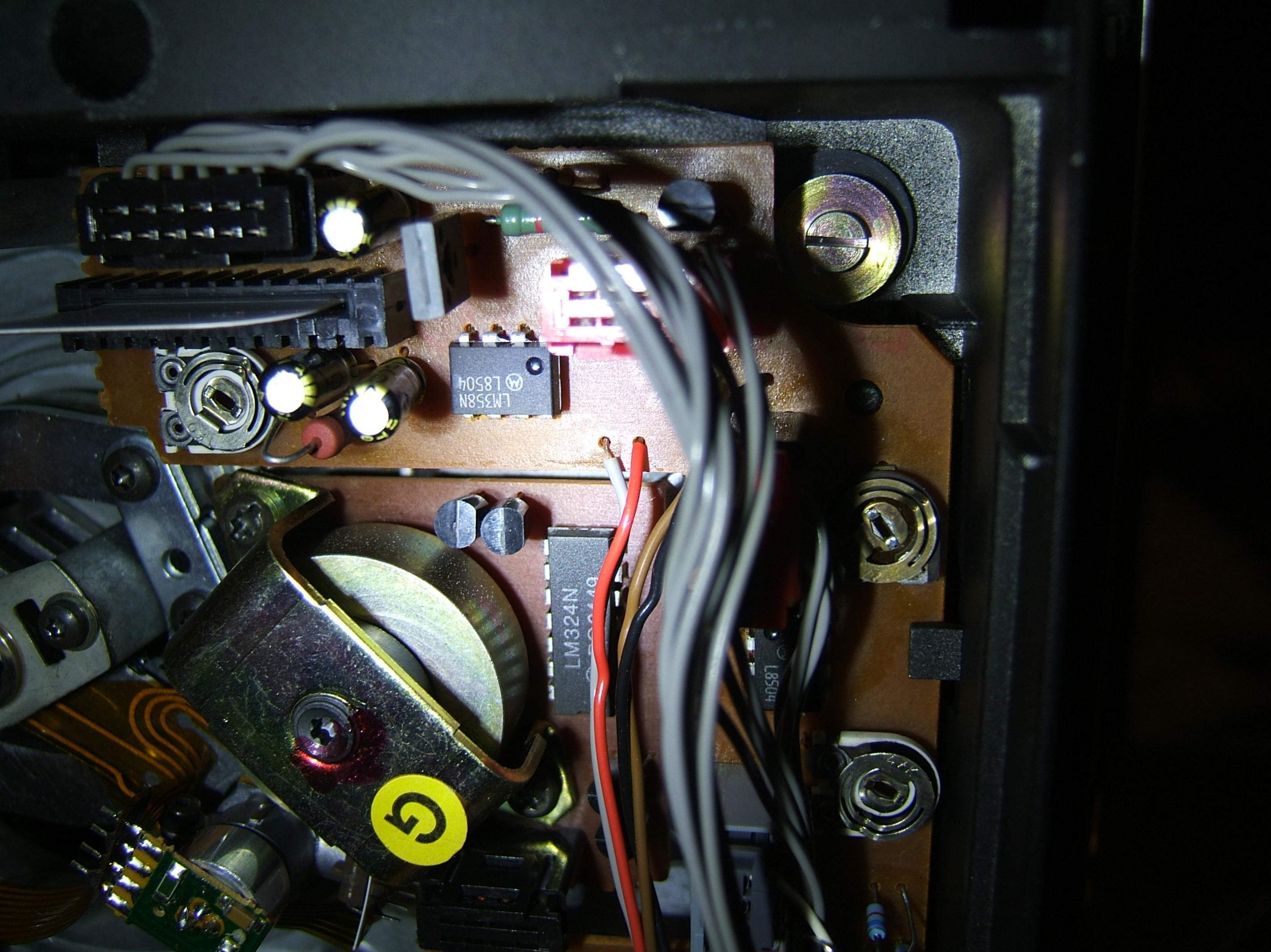

laser pcb pot adjustment
i am doing a full electrolytic recap on this philips cd-204,
im very happy as i found some that were way off the mark, two were really bad ,
any way i recapped the the laser pcb,while i was working i noticed that the 47k pot (which is for focus offset i have read) was maxed out clock wise,
this player was not reading discs before i started ,does any one know why this would be adjusted in this manner?
it does not seen like it would ever be set like this in the factory,is it posible that it was adjusted like this at some point as the caps were way off?
i fear leaving it like this after the recap in case it damages the laser now that things might be working better,
im still waiting for some 68uf caps for the control pcb,this will give me a day or two to work out if it needs to go back to half way,
some pics,its dark here at moment so pics are not to good, ill post better ones in morning,
thanks in advance
mike

It is impossible to say on the preset without you actually going through the set up procedure and seeing if anything is amiss.
The only adjustment that will damage the laser is the 'laser power' setting and again that needs to be checked, however Philips players often have rather convoluted set up procedures making things a little more difficult and open to interpretation.
A good scope and a look at the RF (eye pattern) is the first step and will allow a determination of laser power to be made by confirming the output is around 1.2 to 1.5 volts peak to peak in amplitude.
The official procedure with Philips is normally to look at a small DC voltage across a resistor in the photo diode array circuit of the pickup which can be done in conjunction with visual confirmation using the scope.

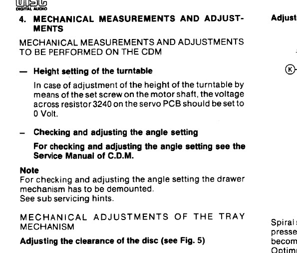

As you say, the height of the platter is going to be altered by the motor thrust washer and there is a procedure in the manual for doing this. The mechanical adjustment will alter the voltage the focus coil needs to bring the lens into the correct position.
CD players that are in good mechanical and electrical adjustment tend to have a very wide range of tolerance on any individual setting. If the player has a problem such as a weak laser or leaky photo diode array... or something mechanical amiss... then adjustment becomes ever more critical and it shouldn't be like that. A good player should literally fall into alignment as you go through the set up procedure. If something seems super critical then there is often an underlying issue.
Again from a CD304 manual:
