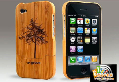

See the awesome looking of laser engraving:

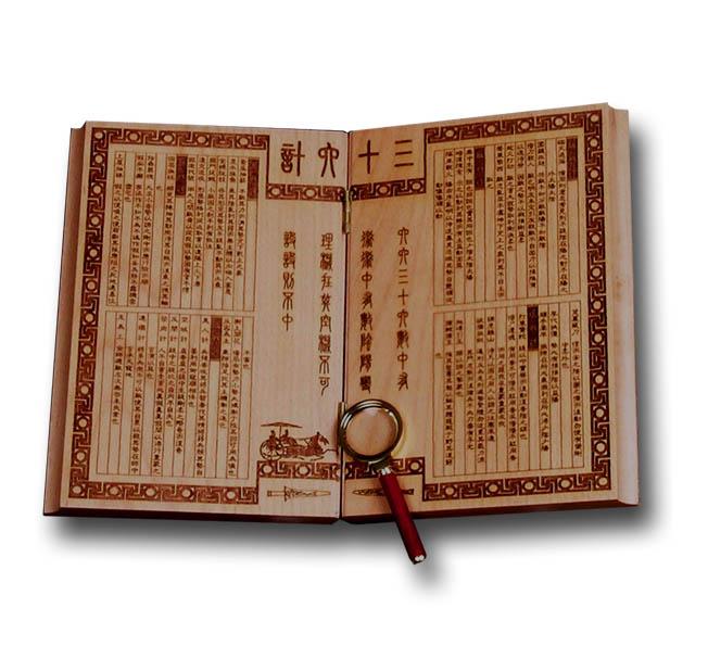

Of course if you are looking for a unique looking for your amplifier, these materials are also available to be engraved:
Feather
Glass
Wood
Bamboo
Plexiglass
Plastic

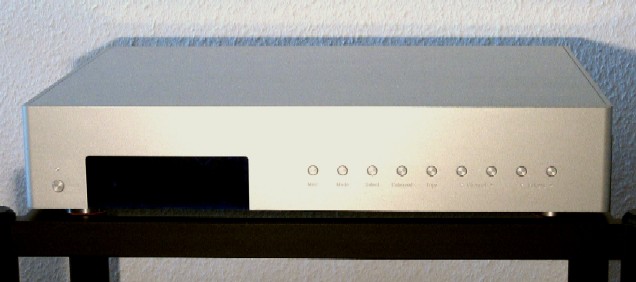

Custom made enclosure with laser engraved logo and wood frontpanel
NERDGASM!
What is the price for something like that? I Need something special for my chip amp en DCB1, and this fits the bill perfect!
It has a nCore logo on it so it mus be goes for nCore amplifier. The frontpanel isn't the one for this customer, I just make this to show him how it looks like. Now I'm waiting for his frontpanel pattern design.

We ourselves also have experience with laser marking anodised aluminium.
We do not call it engraving, as it does not remove any aluminium, or aluminium oxide of the anodised layer.
To do that you would need much high laser power that would leave behind a crater-like surface.
So the laser is purely removing the colour (dye) of the anodised layer.
To do proper engraving on (clear anodised) aluminium, one has to resort to mechanical or chemical means. See :

The top logo is made for the customer under the permission of Hypex. The owner of Hypex nCore Bruno send me the logo himself.
We had tried on clear aluminum. there was nothing with a 40W CO2 laser, 80W can make clear mark on it. But there's no touchable supression on the mark. I think 130W or pulse YAG laser can engrave grooves.
