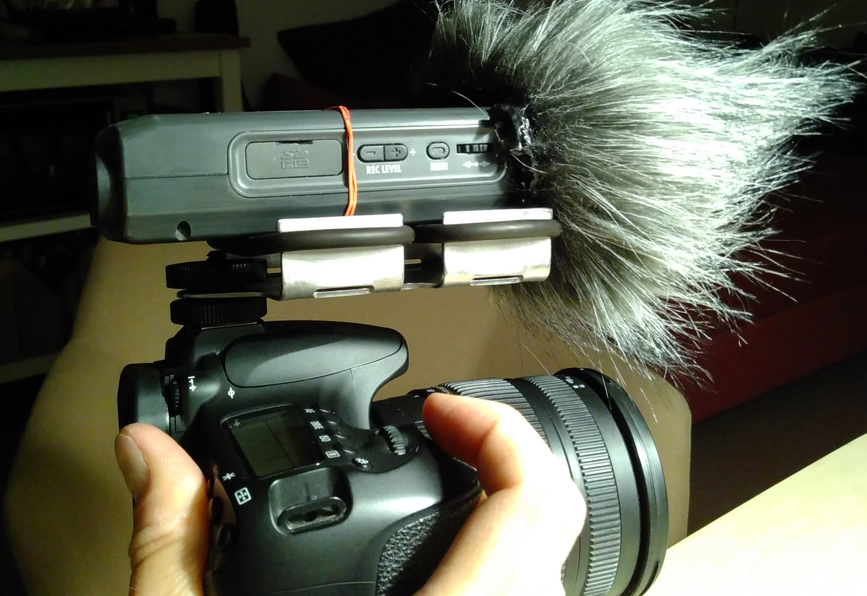

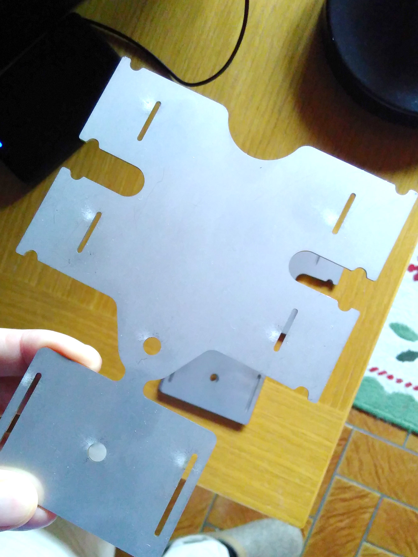

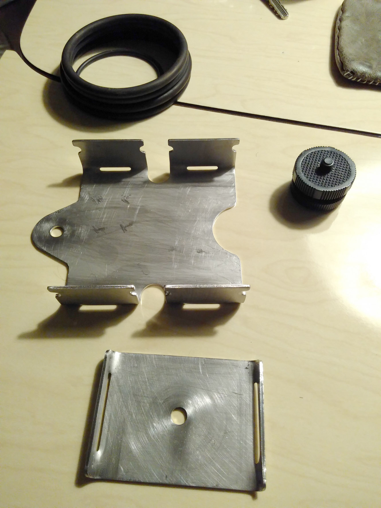

hello, attached find some pictures of my ZOOM-H4N adapter for DSLR, made from laser-cut 1.5 mm stainelss steel sheet ("1.4301" also known as "X5CrNi18-10" or "AISI 304" or "V2A").
the bendings were easily made in a vise.
to save some cutting cost the two parts were made as one and cut manually.

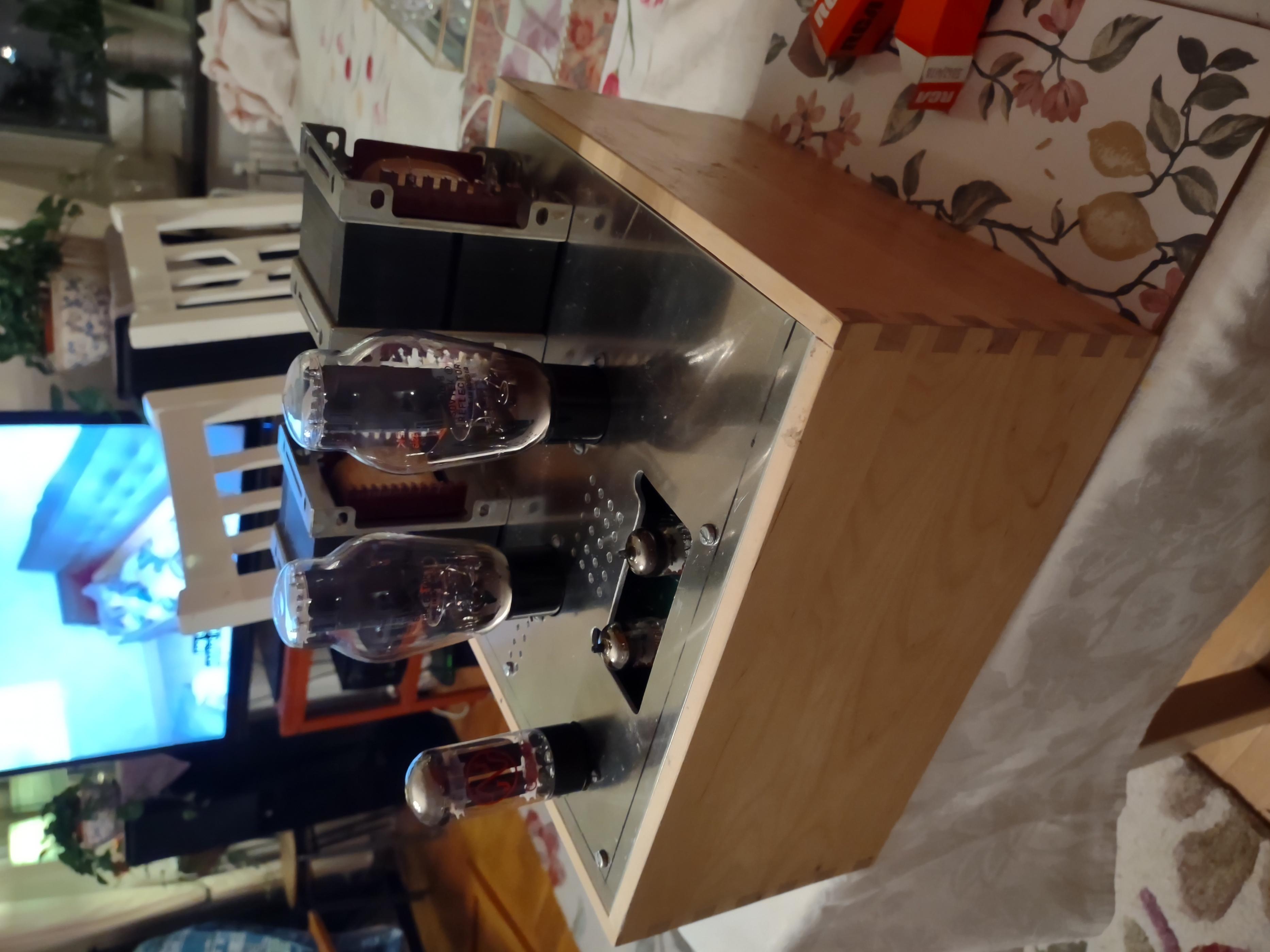

I had discovered some old Ikea wall cabinets that were 25cm square beech boxes, joined with attractive joints, and since I was building the Baby Huey EL34, I was on the look out for a solution for the case for that. I had looked for suppliers of 3mm aluminium, and went over to the machine shop to see if I could order some.
I had no idea how automation had revolutionised these machine shops! The guy said 'how many do you want?', so I said 5, and then it was ...dunk ... dunk ... dunk ... and I had 5 precision cut plates that fit into the cabinet boxes beautifully. (2 of the sheets were used for the Tubelab TSE)
Then he showed me around the machine shop. They have machines for every job in metal working, and most of them can be left unattended overnight, meaning that unit costs can be very low. I asked about top plates, and he asked me to send in a drawing.

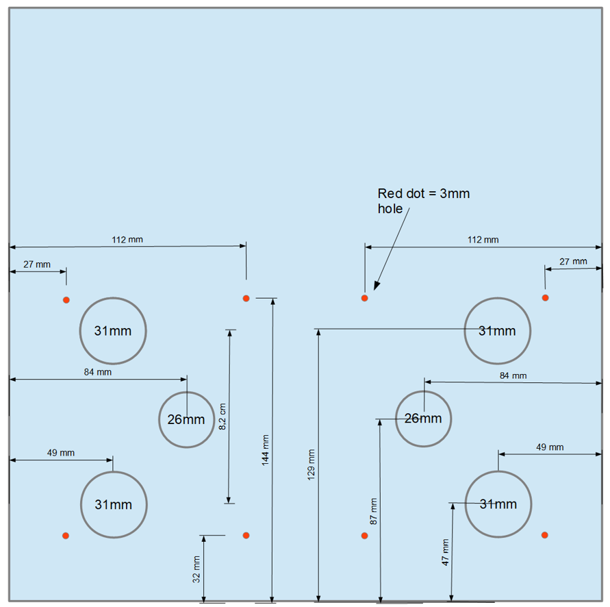

The drawing I provided was below. They convert that into a CAD file, which was a one of fee (£25), and then the plates were produced on a laser cutting machine (£15 quid for the single one I requested).
Unfortunately no picture of what they produced since I work away from home, but suffice to say it was perfect! In hindsight I would do the top plate first, and then use that as a guide for soldering in the bases, since they can be a mm or 2 off.
So, long story short, I think we are missing a trick or two here. We produce these wonderful PCB templates that can be replicated for small sums onto good quality PCBs, but we could also be providing CAD files for the top plates, going to a local matel plate specialist, and having short runs of the top plates, or cases being produced for us. Bending is possible, with the proviso that not all bends in all alloys are clean, cutting is via laser or drill heads, depending on the number and the size of the batch. The possibilities are legion!

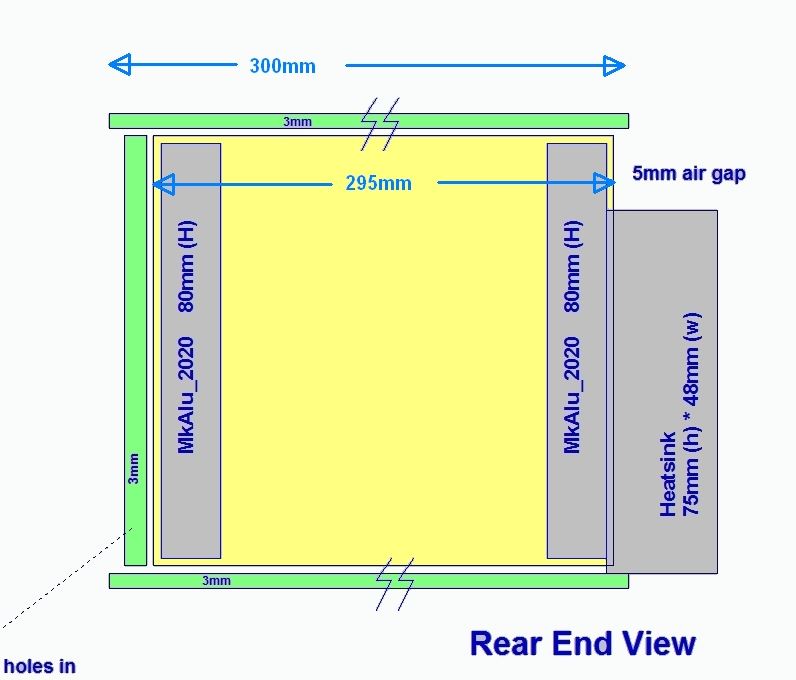

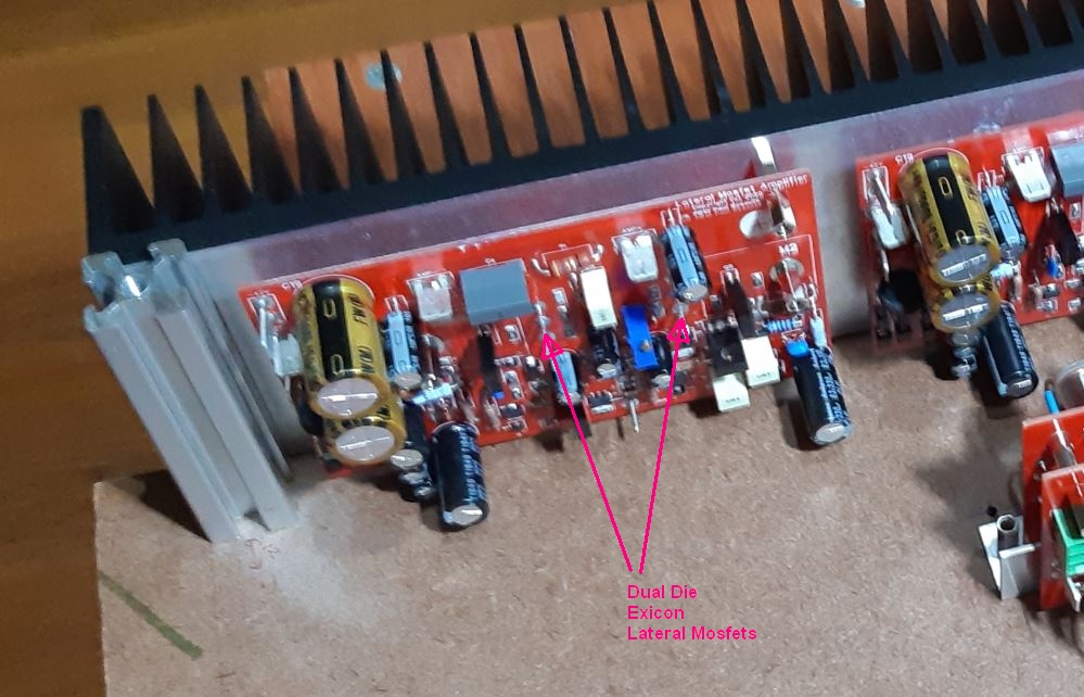

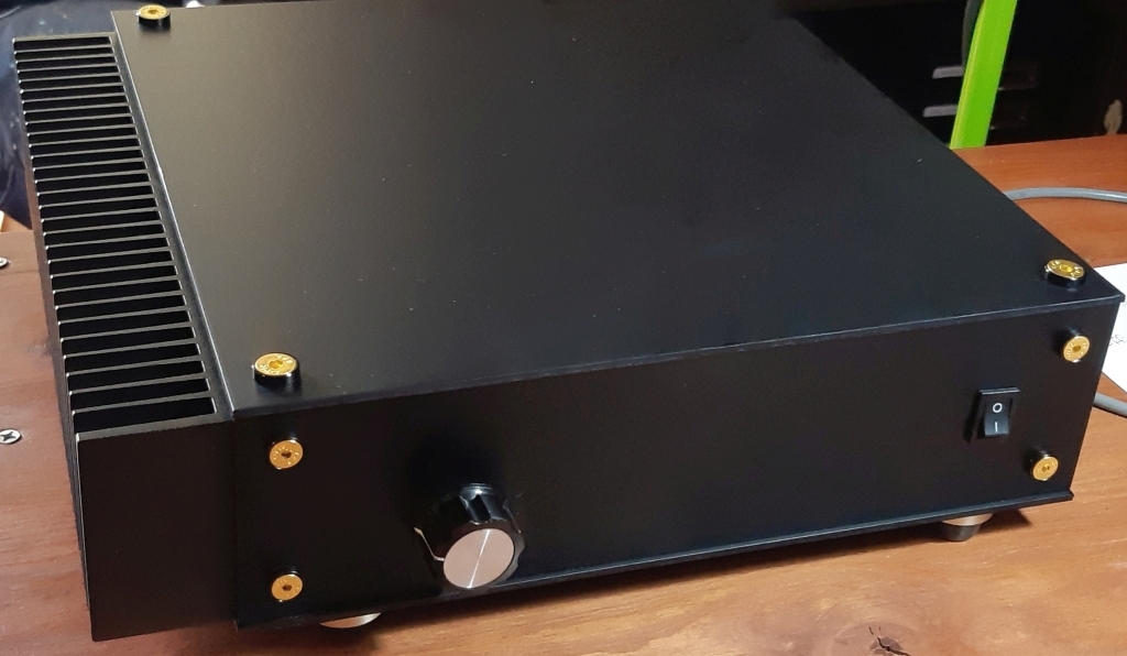

I recently designed and made a small 60 watt amplifier using just flat aluminium sheets or bar.
I used 20mm * 20mm extrusions from MKALU, who cut and tapped them, and then had an aluminium supplier cut 3mm aluminium sheet to size. It still involved a day on a milling machine to drill holes and cutouts. Next time (if there is a next time), I'll have them laser cut.
This method makes for a reasonable chassis that is very easy to assemble.

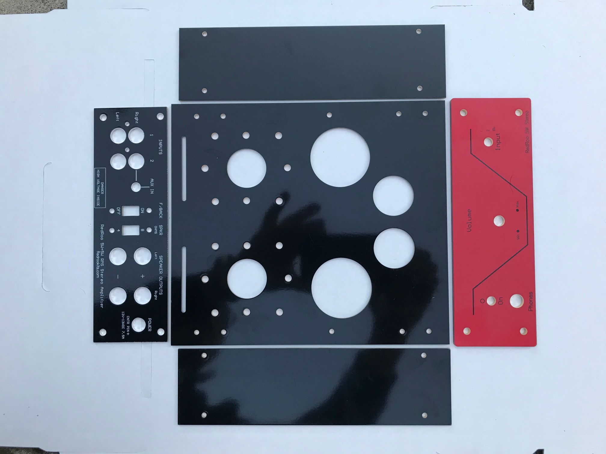

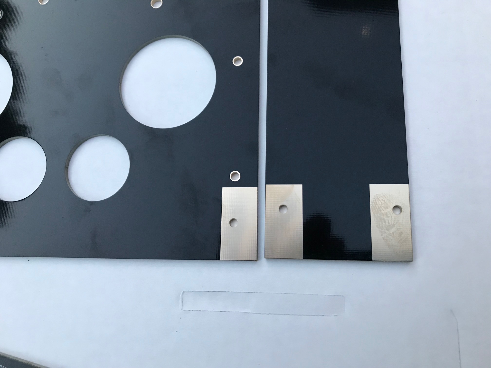

Here are some pics of flat chassis panels made from 2mm thick fiberglass PC Board with black and red solder masks. The front panel was done in 3.2mm but it's quite expensive compared to 2mm. The rear side has a masked-off area to allow continuity through corner brackets. That's me you can see in the shadows.
You can see how the final amp looks at Tube - Valve Stereo Amplifier to Build Yourself | RedRoo Kits

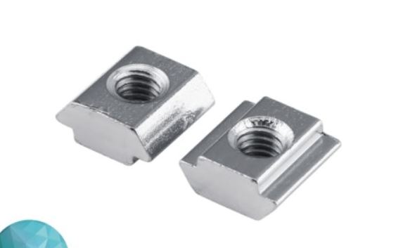

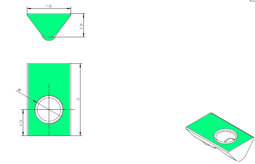

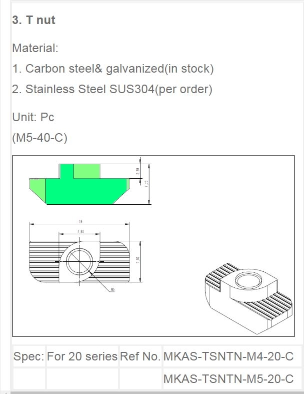

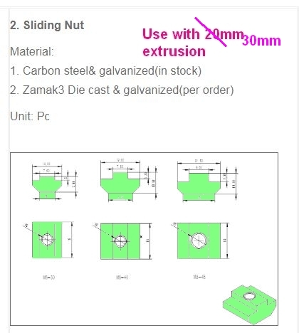

I used Sliding T Nuts in both 4mm (sides) and 5mm (front), but there are a variety of options ...
