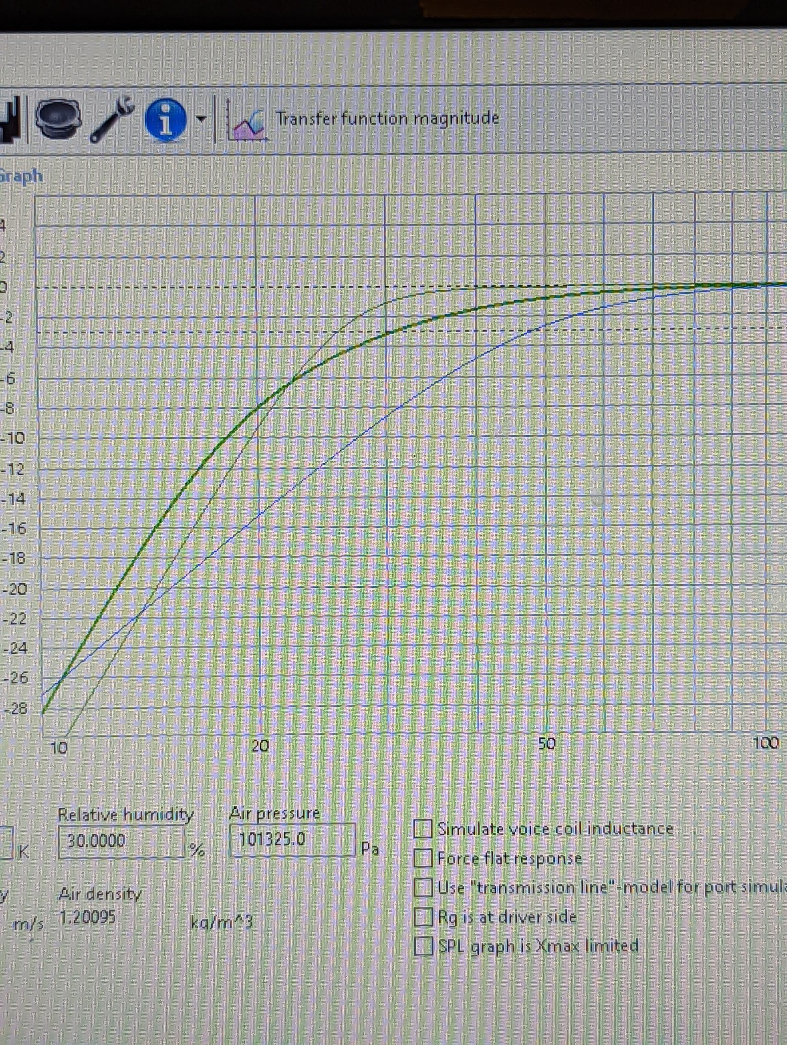

Where in Missouri are you?? I've been working on a similar project....You said a bit more bass...If my modeling is correct you could have A LOT more bass! Sub 20hz extension...with a 4 cubic foot enclosure and a huge port tuned to about 21.5hz...the only way I figured I could do this is suspend the speaker on feet and vent out the bottom...I actually gave John Devore the idea for the Orangutan! Lol...I'm in independence

The bold green line is my alignment ...I built a sonotube sub with a 12" woofer that actually had a similar curve...it's fabulous...with a smooth exponential roll off it works with room acoustics instead of against them since it's approximately a mirror reverse of typical room gain...so I'm expecting them to have full bass extension....

The other aspect of my design is to use a standard tweeter in a waveguide instead of the XL exotic tweeter that comes with the A26 kit....going on Zaph audios TMM design, the waveguide should allow to tweeter to go plenty low enough to be crossed with the A26re4 woofer..
