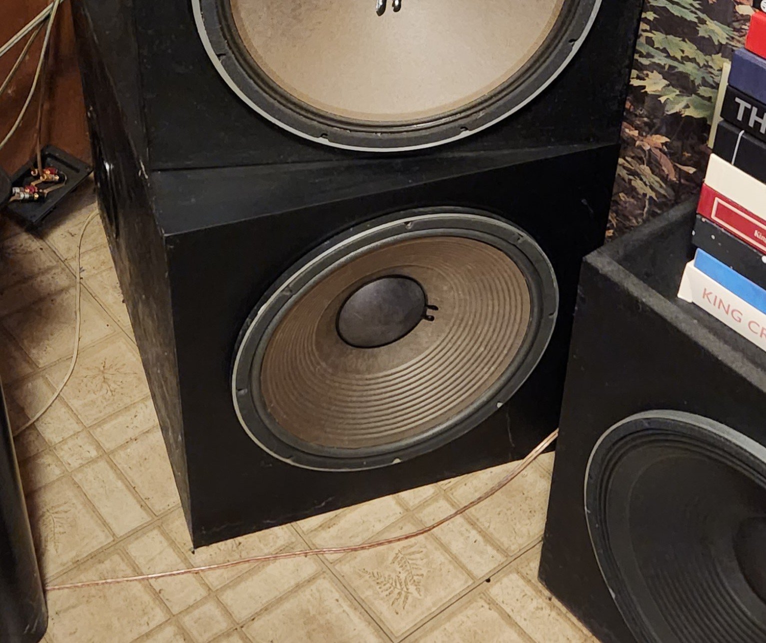

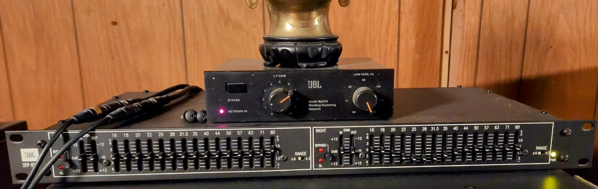

I have been using "subs" under my mains for years now. It's part of my HT set-up so I also have LFE subs. When I run in stereo I use only the 2 suns under the mains. It's a pair of DIY B380's using EQ from BX-63A 15" 2235's to flatten the response. It's part of an active analog set-up and is placed asymmetrically in the room which actually helps. I have a cut only stereo subwoofer EQ to help smoothed out and balance the response. It works just fine and gives me a full octave and a half of usable response to 20hz below the mains.

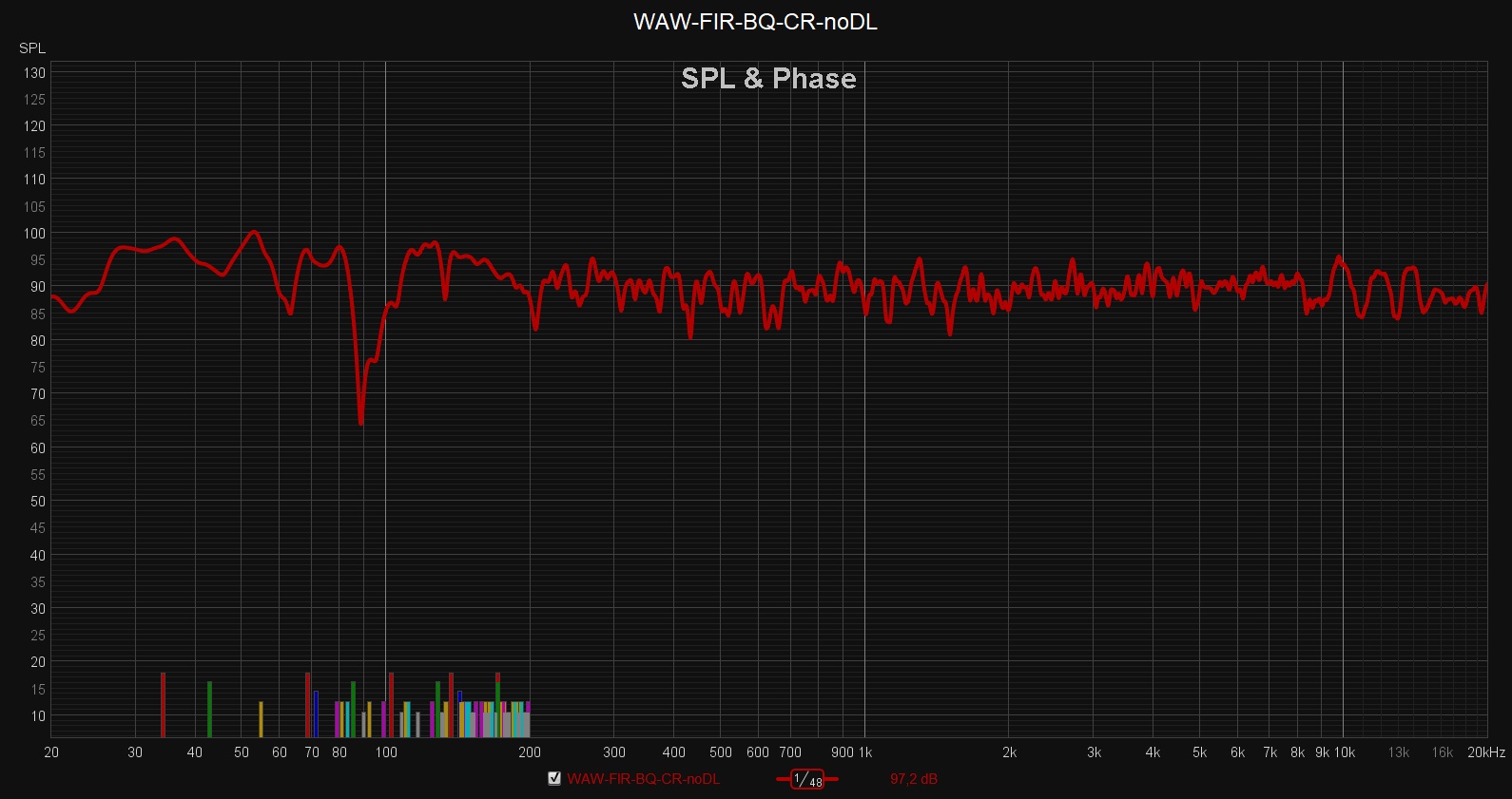

It depends on what you call big, but my main system is a 10" Scanspeak 26W8534G000 in a 77L sealed cabinet and a 5.5" (cone) Mark Audio Alpair 10.3 fullrange driver in a 11.5L sealed cabinet crosssed at 300Hz. These days i use a MiniDSP flex with it and got to this result in my room (without using DIRAC). The cut at 90Hz is a room mode as this is measured from my seating position. I was planning to use DIRAC, but i don't feel the need of it (disclamier: i tuned dozens of dsp's back in my sound engineer days, mainly for high power dj setups or private hifi of others).
You can do a lot with eq, but the limit will always be how much xmax and what FS your woofer has. You can't get arround that xmax limit without going into distortion (and ultimate into destruction), and tuning way below the fs is often also not a good id. Also room modes are hard to fix, boosting it at that frequency won't help as the cancelation at that frequency also get boosted. But if you stay in that limits and make your boosts a wide boost, not a peaky one, you can do a lot with eq without destroying the good sound.
