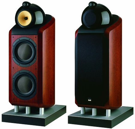

I listened to some B&W 800D (two 12" bass drivers) and 801D (one 15") floor standing loudspeakers and was VERY impressed. B&W does a terrific job of the mids and highs but it's the bass that really blew me away. Even in relatively "bright" tracks you can tell there is deep thunderous bass on tap, ready to fire. Everything about those speakers gives you the feeling to crank it up LOUD and really get into the music. :devilr: And even at that, they never sound "loud" in a negative sense, probably because of how smooth they sound.
But they run roughly $16,000. Thats a little (lot?!) prohibitive for me, and I have a feeling I can get close for a LOT less. I have a bit of DIY audio experience and will be working with an expert craftsman in woodwork. I have a very rough idea of what I want, maybe Scanspeak 18W8545 mids, Focal TC120Tdx2 tweeters and 2 Dayton RSHF 12" woofers per speaker. How are these woofers in terms of sound? They are quite cheap, compared with say a Focal Audiom 13 so I wonder how they would turn out in a project such as this. Has anyone done a similar project with favorable results? I saw the Andromeda DIY tutorial online which actually got me into the whole idea of building my speakers.

I've got to imagine some body has tried to replicate an 801D or some such as far as sound? I know the design is a bit difficult with curves and balls etc, but I really only care about the sound. We can make it look good on our own. 🙂
801D - one 15" bass driver. One 6.5" mid.
800D - two 12" bass drivers. One 6.5" mid.

b&w spends alot of time r&d and makes really nice cabs. It would take a tremendous amount of work to imitate. If you want your bass to sound just like the speakers you listen to, be prepare to do lots of cabinet work.
