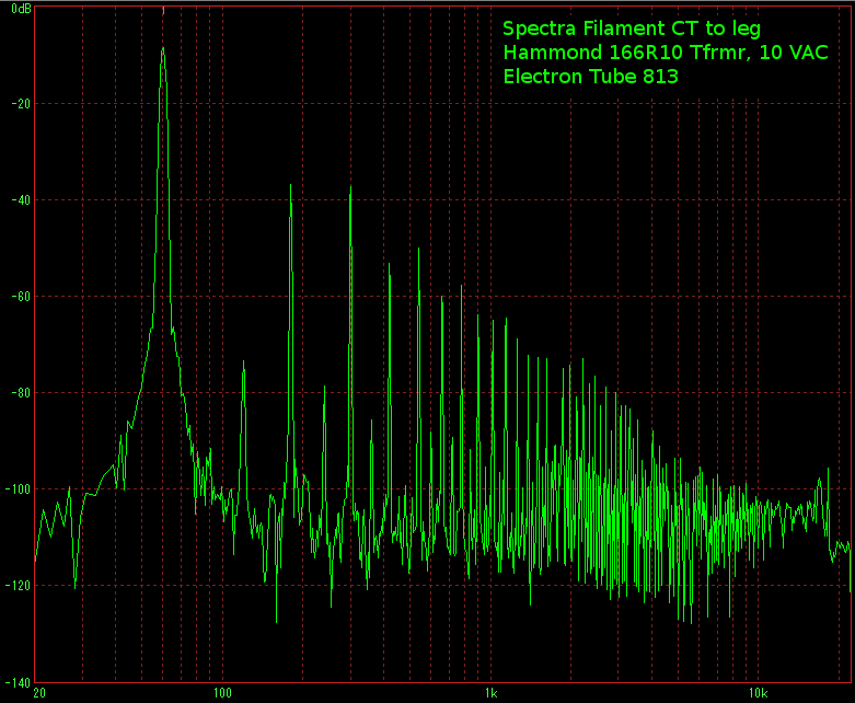

4.7uF isn't going to do any cleanup of 50 Hz - 20 kHz noise on the AC mains. It's only effective in the 100's of kHz to low MHz.
A Torus Power isolation transformer would reduce noise above 2 kHz. It's -12 dB per decade above 2 kHz. But they aren't cheap!
