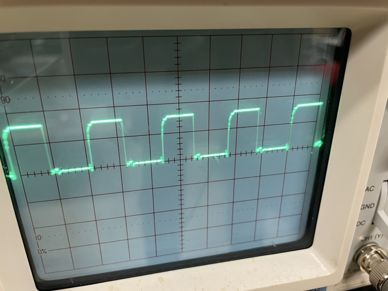

Then I went ahead and put 4x IRF3205 with 47ohm (Also tried 22 ohm) gate resistors. I pulled the two large rectifiers out of circuit for now.
The PS FETs are getting warm and the waveform on their gates doesn't look so great. Current draw is 1.3 amps.
That didn’t change much with a 470ohm temporary resistor. Fets still get too warm after about 10 seconds.
I also tried jumping a lead over the 47ohm driver gate resistors between the SG and the base of the BDs. That actually helped some but the fets still get warm after about 30 seconds.
Let me post a clearer photo of the signal at the gates now.
Still,
Rectifiers out of circuit
Jumped 47ohm gates
470o temporary between E&C
The first image where you can see part of my power supply is the signal at the gates.
The second image is from pin 14 or 11 of the SG

I went ahead and put them back in. Seems to be running fine and cool now, except Q41, Q42, Q15 and Q16 are getting warm. Probably fine though. I’ll put this one back together with minimal resistor modifications.
This supply uses no deadtime resistor so deadtime is as low as possible. This isn't a problem but when running at the maximum duty cycle, it shows up in FET heating. When the rectifiers are int he circuit, the rails feedback to the 3525 and force it to reduce the duty cycle. Even the slightest reduction in duty cycle eliminates the heating.
One problem with the drive on this amp is the abnormally high operating frequency. That alone can make slight changes in the drive.
Thank you. This amp is back together and ready for some high amperage testing tomorrow.
