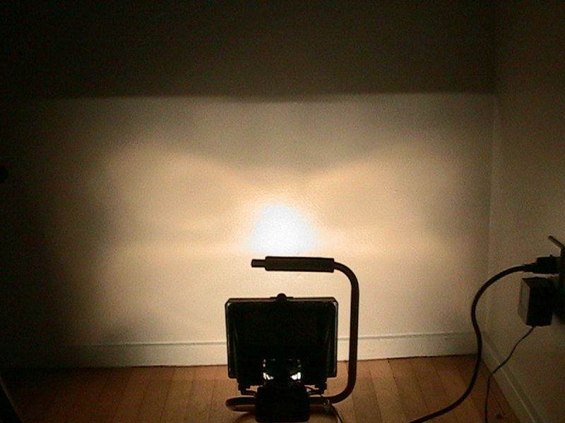

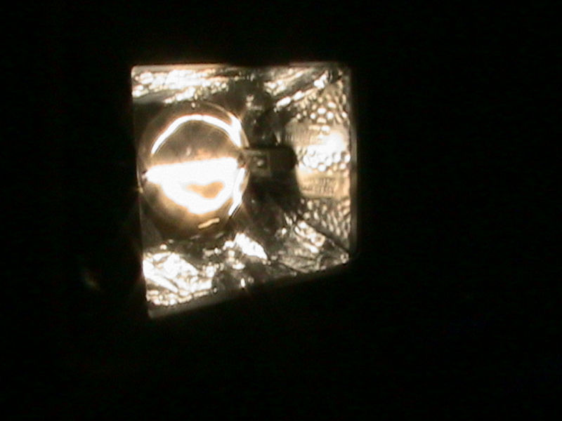

Hi, I am new here, but am trying to get the bal rolling on a cheap projector system for my living room 🙂
I just picked up one of the halogen work lights our local Zellers had and wow, yes it is bright and hot, very hot. I made a reflector $1.15 soup ladle....for the 500 watt halogen bulb and that improved things quite a bit in the light department (at least as far as the dirrection it was pointing, remember this was intended to be a flood light).
I did notice the light was awfully yellow, (like most halogens) so I went to my building supply store and looked around. I found a sylvania 500 watt 500T3Q/CL/BL/119MM that claims to beable to produce "Brilliant White Light". So for $6.95CAD I thought I'd see. Well, it is whiter, much whiter but I wouldn't call it day light....certainly blinding, but not exactly brilliant 🙂
I am hopeing to find an all metal older OHP to use so it won't ******** melt 🙂, and I want to chop a hole in the back of it to aim the whole work lamp in from behind at the mirror that is usually on the front wall at an angle. Taht way I can have a fan exahusting fro the whole projector and one that I am in the process of retro-fitting to my work light cooling the bulb. (I am also a bit paranoid about having the halogen explode and dest fresnel of the OHP.
I plan on going the Pull down vinyl blind route when completed for a screen, as my living room is pretty small.
I just had one other concern though, and that was, how big will my image be if my projector has to be 13ft from my screen? I don't want an 72" projection. I just want something that will rival a 42" plasma for size, but be cheaper than a massive REar projection of the same viewing size.
Any questions comments or help would be appreciated, also cheap sources for LCD's in Canada (I have searched the forrum, but can't seem to find much on the er...cheap side of the fence).

Thanks for the help, I don't suppose you know if it too easy to take the existing one from and overhead projector and fit a long throw lense from the DIY store? I may have to go that route, as I want to get at least 800x600 for watching dvd's on, and means I'll likely end up with a 14 inch LCD or larger. Hmmm, I'll have to see if it is possible to make a long throw lense from what I am will be getting. Thanks again.
Oh, I have a pic of my "new" fan vent on the back, it actually seems to make a difference, and there isn't that much light leakage from the unit.
Also included some of the light just for fun, I had to put my crappy little camera to "spotlight" setting to view the light at all with the reflector. Please note, that the light appear about much brighter in person (can't look at it at all), and my digital camera is part of my cannon 65mc miniDV. (only 1024x768).
