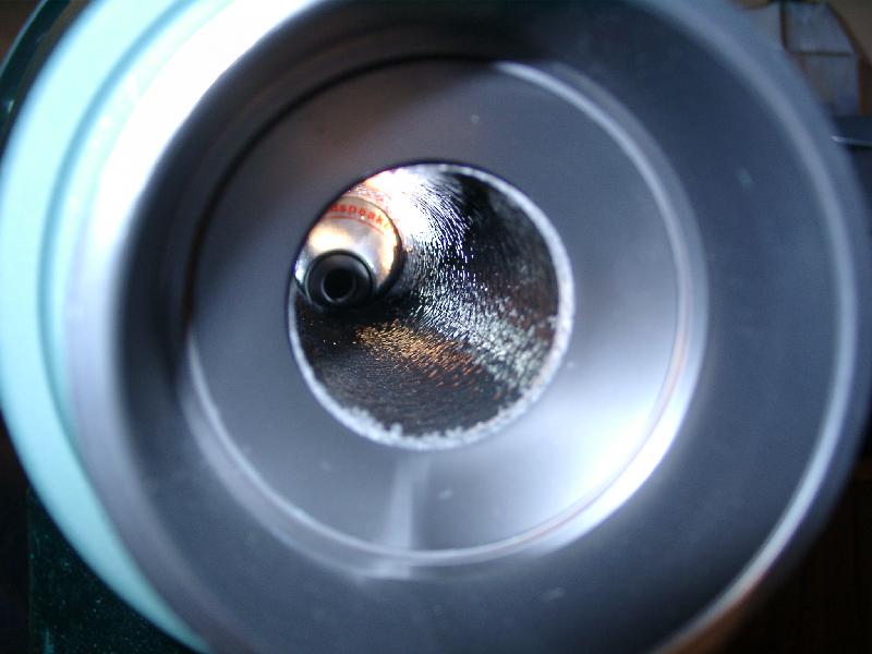

Apropos, just made a new port out of 2" ABS.
I noticed that the inner wall of the pipe is not smooth, as is my 1.5" and 3" ABS. It's as you describe, like the surface of a golf ball, though perhaps not quite so dramatic. I got a good picture of it, which I'll have up on my web site in a day or two. I really doubt it helps much, plus the exit of the port flares from 2" to 3", but who knows? I can't hear port noise at any output level except using test tones. This is only using a 6.5" woofer with 4mm of Xmax, though, tuned to the low 40s. 🙂

Sorry, I really have no idea! It would be cool if that were true, seeing that's how my speakers worked out, but I sure didn't plan it that way. 🙂 I just bought the parts at Home Depot and that's how they came. I don't know how easy it would be to add a dimpled texture to the inside of a smooth port. I know I have seen people completelyl fill a port with drinking straws, but I forget the theory behind the improvements claimed for it.
I can only speculate that there must be some reason the inside of my ABS pipe is textured the way it is, and one would certainly expect that it's not there to INCREASE friction.
What parts? dimpled?
Yes, the pipe came with a non smooth interior.
I have purchased the same kind of pipe in 1.5" diameter and 3" diameter, and it's as smooth on the inside as on the outside. Not so this 2". The picture below should explain what I mean, and you can also see the flare, which is nothing but a 2" to 3" coupler. Total port cost is about $2.50, though it doesn't come with a fancy flange like those Precision flared ports. Oh, this was a 10' length of pipe, cost about $4.00. That will last a lot of projects. And yes, that is the back of the woofer you are looking at in the port, which is about 1" away from the end of the port. I know it's probably heretical, but so far I don't hear anything bad, and the speakers are deep enough already without moving the port out more.

That is creative, A+. Suggestion: Where the ID meets the coupler (flair), sand down the ID to make a seamless mating without the ridge. This would eliminate a source for turbulent noise.
