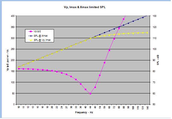

But as I'm very happy with the sound of my Lambda Dipole-15 with the bass guitar, I thought of placing the TD15H in a closed box with 70 liters.
Simulation looks good, and there should be nearly 110 db output at 40Hz.
Any opinions?

yes, also try simulate the other AE 15" 😉
anyway, the very low Fs of these woofers certainly help gettin them go low, despite a low Qts
right from the hip, I would bet on the TD15X
they all have very high VAS, so kind of od creatures fore a small box
but as said, the very low Fs might do wonders
maybe take care not to get too much peak at lowend rolloff

That is a good idea, maybe with an removable back wall in in the enclosure.
The simulation gives no indication of a peak with 70 liters.
you are right about it
its the very low Qts
