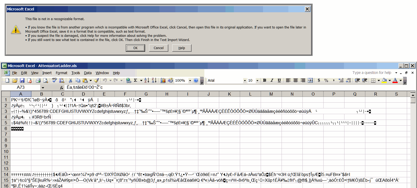

(excel calcsheet included as zip-file)

Too cool for me too. Can't read the MacOS "numbers" file. (It is not an "excel".)

As for the notsocool numbers-format, my bad. Here's an export into .xlsx, which hopefully was converted correctly.
