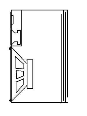

I'm planning to build reflex port as rectangular version to be part of the enclosure. I have been thinking of building reflex port as labyrinth into the enclosure. I'm afraid that 180 degree turns affect tuning.
Is the reflex port in the picture incorrect way to build it into the enclosure? Does it ruin the reflex tuning somehow?

If the port is to scale please check your sims as the vent area looks small and you may get port chuffing.
The length of the port does put you into the realms of transmission line/horn enlosure design-if you are using BBpro you can "add port resonances" to your SPL output graph.

In that box with that port the first port resonance will be at 179Hz, so unless you are crossing HP to that driver lower than 80hz you will have problems. Second, the port ratio is 1:15 (height:width) which is way to high, 1:4 is generally the maximum ratio before you have to derate the port because of surface friction.
The real question is how high (Hz) will the bass driver be used? That will determine the longest port you can use before port resonances become a problem.
I suspect passive radiators will be the answer to your tuning problems. It almost always is when using a box that small.

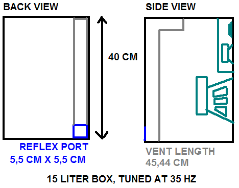

Would there be any problems with this design?
15 liter effective volume (excluding reflex port etc) tuned at 35 Hz.
According to winisd alpha first port resonance would be at 378 Hz.
5,5 cm x 5,5 cm port with length of 45,44 cm making one 90 degree turn in the upper corner of the box.
Picture is not in scale.
I see no problem as long as you don't send more than 25w to the LF driver.
To use the LF driver with 75w, 35Hz tuning, the port should be 10cm x 5.5cm x 84.5cm.
keep in mind the air velocity maximums are dependent on the size of the port, check out Flare-it - Free Speaker Design Software it's a handy little program.
