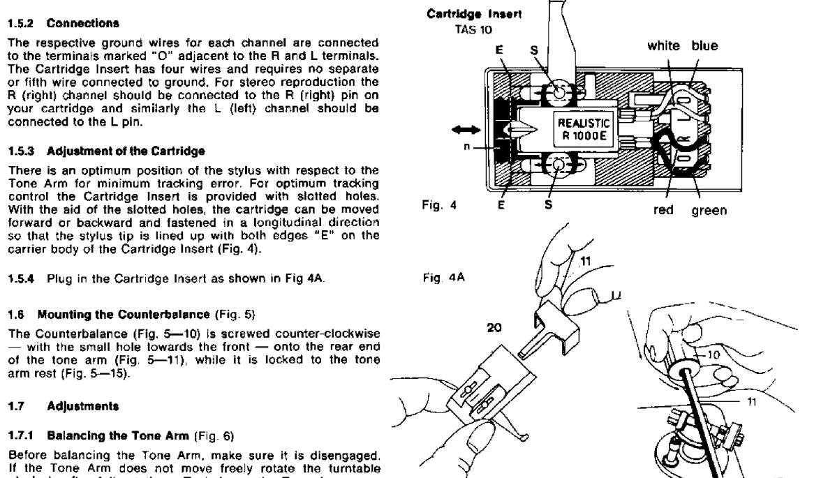

Hello. I have an old Realistic Lab-58 TT with a Realistic STA-530 receiver. I had a guy at a vinyl shop revive it after it spent a long time in the attic. It works, but I think it needs some setting up and it looks like that will have to be a diy project. I read a few articles about VTA, anti-skate and all that, but I had a hard time figuring out how to apply what I was reading to the turntable in front of me. I couldn't find any information on my specific turntable except that it comes from around 1980. I also don't know what sort of cartridge I have or what the manufacturer guidelines for anything might be.
I took some pictures, and I hope this link works:
Realistic Lab-58 Photos by vinylnewb | Photobucket
If anyone could point me to some useful guides and alignment tools, that would be very helpful, and I'd especially appreciate some help in figuring out what I have to work with on this particular turntable. For example, there's some sort of switch with the numbers 30, 25, 17, 12, 10, and 7. What is this? What does it do?

You have a good picture of it, but I see no markings. I'd say 'remove the cart via the head shell', but you should really find a manual for the table and tonearm first. You don't want to twist it incorrectly and tear the fine wiring inside the arm. The stylus is very fragile as well. The cart looks like a moving magnet, but I could be wrong. Cartridges are user replaceable, so it might not be original and not listed in the manual.
The head shell covers and holds the cart. The head shell attaches to the tonearm shaft.
Sometimes the head shell plugs right into the arm shaft, and other types have a locking collar at the connection point behind the head shell. Some are one piece, head shell direct into the arm.
Try the lab-60 manual, it might get you close to finding the cartridge type. most likely a moving-magnet Realistic/Shure. Look for model number on physical cart.
