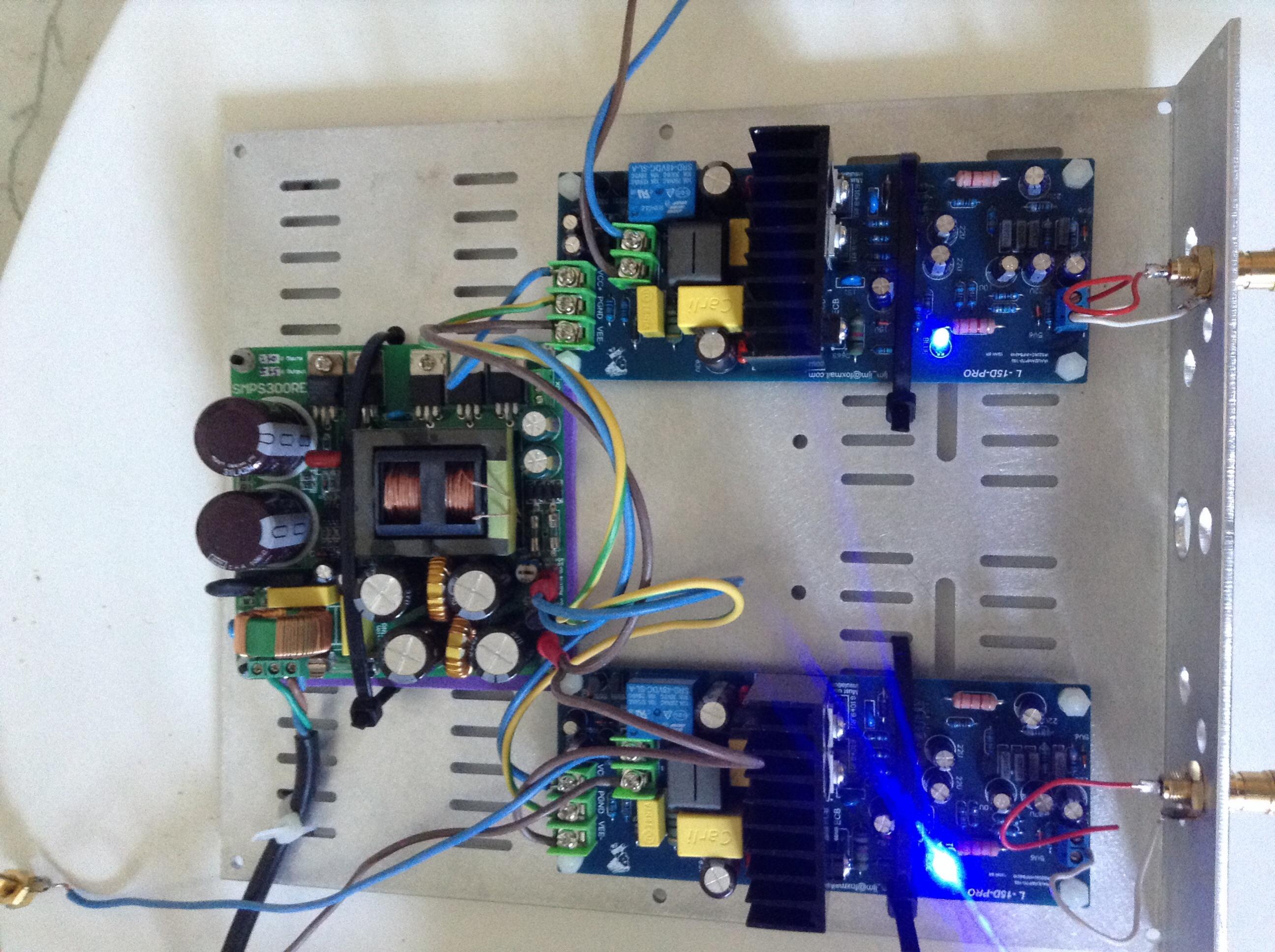

I have a pair of these running off a connexelectronic 45v/300w SMPS and my first impression is that they sound a little flat. I was wondering if the PS is powerfull enough to drive both amps or if there is anything else i shoud check? Would a linear PS help ?

your better off with linear and capacitor bank. I also tried it with SMPS psu and true enough its kinda lacking in low end, but when i put back the linear psu with 10K uf capacitance on each rail lows become apparent and better SQ.

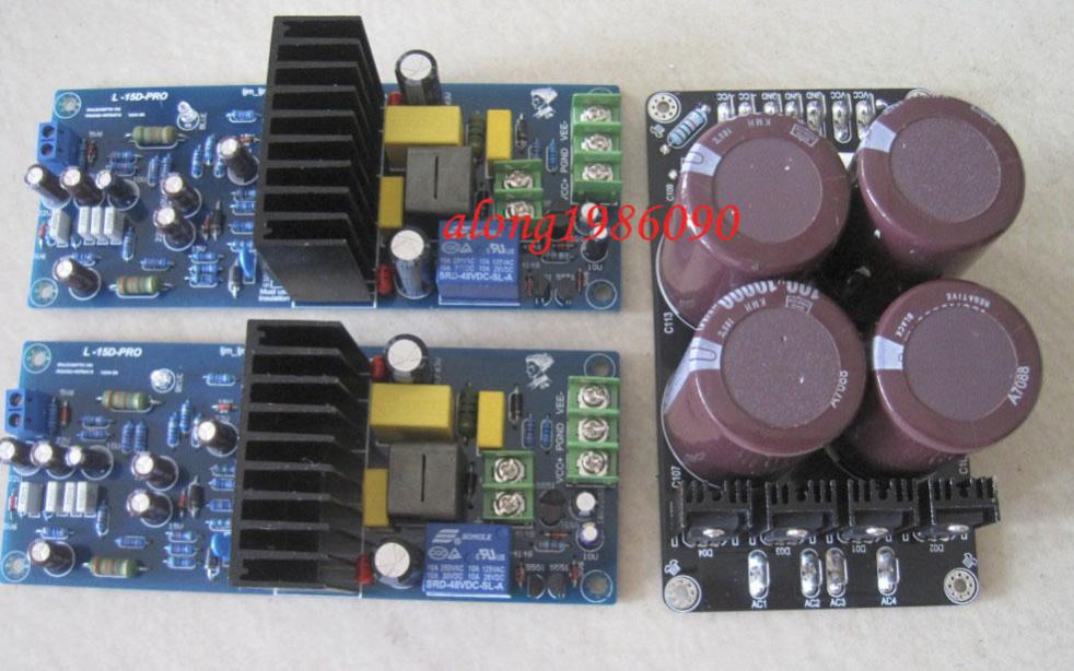

ok, thank's. I got a PS board with 4 huge capacitors on it 10k each I think. I just need to find a suitable transformer to be ble to use it. In the mean time, I'll push the voltage of the SMPS to its max (+5%) an see (listen) if that will affect the Sound.

I think you can also try putting your capacitor between smps and the L15d,just connect the polarity on its proper position,how many volts and ampere is your smps?

Try adding the capacitor bank to the SMPS, nothing to lose.

can I really do that ? the PS board I have is for AC input I thought and has a rectifier section on it which outputs DC. I've added a pic of the PSU board.

One thing that may indicate that the PSU is underrated, is that when the volume is pushed to the max with some bassy music the amps shut off automatically, maybe indicating an undercurrent state... although im just guessing.
