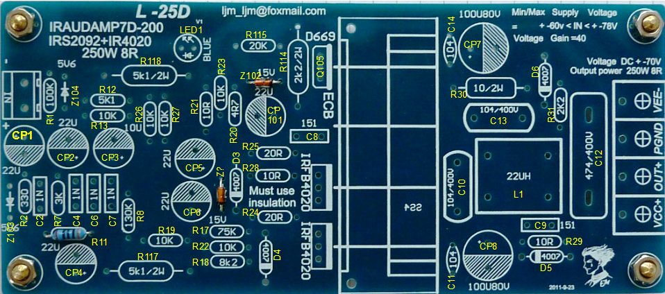

Hello,
I have multiple ljm L15D Pro Boards. SMPS is a connexelectronic. I have a multichannel system and the speakers are active.
My Problem: The Front speakers (tweeter + midrange) both have a very high sensitivity (97dB/1w/1m). So there is a noticeable noise at the listening postiztion. The other speakers which are not so sensitive are quiet. The source Volume (4,9V DAC) is in the moment trimmed by an analog attenuater (trim poti) and the main volume is controlled digitally.
Is it possible to change the gain factor of the amp, so the noise could be lower?
PS: The noise is independant of the volume setting.

Hi Jens ,
See this post : LJM Gain L25-D Gain Help
gain Resistors on the L15Dpro seems to be in the same position as on the L25D
Cheers ,
Rens
