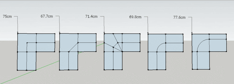

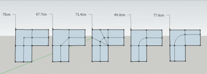

I’ve encountered a problem while determing the ports for my cabinet. I’m not sure where exactly I should measure from and how to do it correctly. Does port represent only blue part or with green? Or only green, and blue part as a front chamber?
So far, I’ve been using ChatGPT to calculate and tune the ports for me, but I’ll admit, I’d really appreciate some feedback and opinions from professionals.
I’m attaching a file with my design for reference.
All of the above, including separately where their resonance happens due to the bend.Does port represent only blue part or with green? Or only green, and blue part as a front chamber?

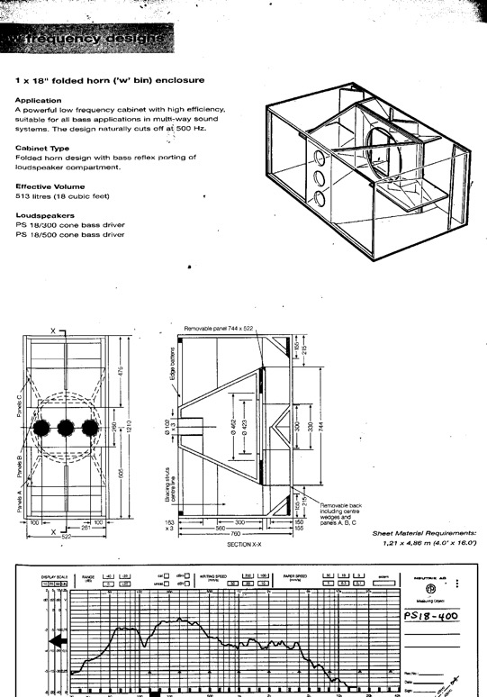

I'd make a different shape depending whether it was better to pass larger or smaller wavelengths.
Yes I agree, I reshape it to look more like OG W-Bin. Thats make more sense.I'd make a different shape depending whether it was better to pass larger or smaller wavelengths.
Iam trying to put parameter to hornresp, and have some calculations done 😅, but I have a question, how do you calculate w-bin horn? U divide by 2 coz it looks like to horns, or calculate only one segment?
Have you checked info on Klipsch LaScala and Peavey FH-1 speakers given that's 'sorta' what you've drawn? A Google will show you a great number of design drawings, opinions, measurements, etc.
Thanks for sugestions, I was referencing those ones.
