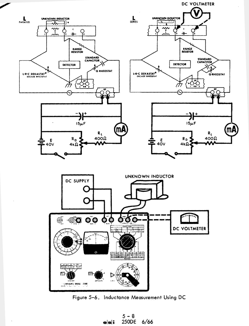

A bridge circuit is pretty easy to build --
I don't see how that works; it looks as though all it's doing is measuring the dc resistance of the inductor.
To measure inductance, which is defined in terms of rate of change of current, you need a signal that changes with time.
Of course it's easiest to get an inductance bridge, or even one of those old G-R or EICO or Heath impedance bridges. (I have an extra G-R bridge.)
It is a bridge, an ESI 250 Bridge --

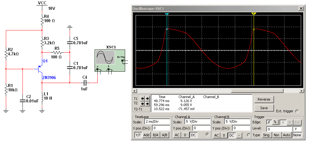

Getting back -- you can make a Colpitts oscillator with just one transistor -- in this case the time interval of 10mS is proportionate to the value of the inductor:
Is that bridge circuit doing it ballistically? Close the switch and look for the direction of deflection on the detector?
It ought to be possible to just build an oscillator with the DUT and a few switchable reference capacitors, and read the frequency with the counter.
