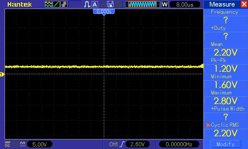

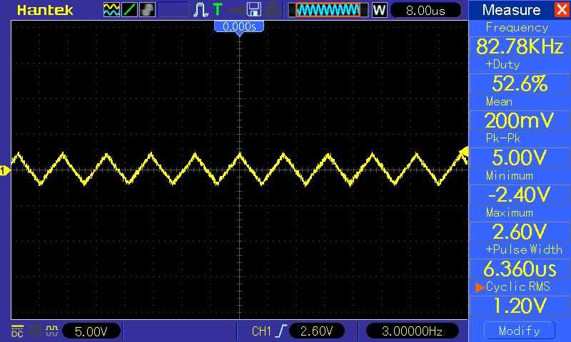

Check U14-Pin 4 then Pin 11 with your scope, using signal ground for scope GND. Post screens shots.

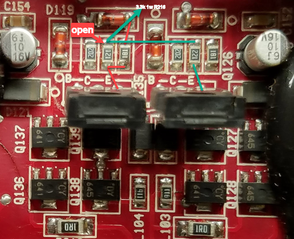

There is a disruption in the feedback loop, check the drivers Q113,Q104,Q135,Q126 and associated components around them, check L105,L106-output inductors and connections.
I found a resistor open R215 120ohm off the collector of Q135. I replaced temp. with a through hole 120ohm resistor. ( don't have a smd 120). Still the same results, pin 4 has a signal, but don't have it on Pin 11. Checked all surrounding components all seem to check good.
I am using a KX1200.1 print it seems to be pretty dang close to it. I dont see the 4.7 ohm resistor off of D116 and R193, it may not even be on this board. But if it was open it may be the problem.

I'm not sure what 4.7 ohm your referring to. D116 and R193 are part of the over current protection.
It's possible Q135 has failed. Check L104 with an ohmmeter, it may be open.

I don't have any notes handy. Compare the voltages with Q113-A1381. You can also try replace Q135 if you have the part.
Quick question, if I unsolder pin 11 on LM361, should I have a signal then, if there is nothing wrong with the IC
Let me rephrase that question. If I removed all 4 transistors Q104,113,126, and 135. Shouldn't I get a signal on pin 11 of the LM361?
