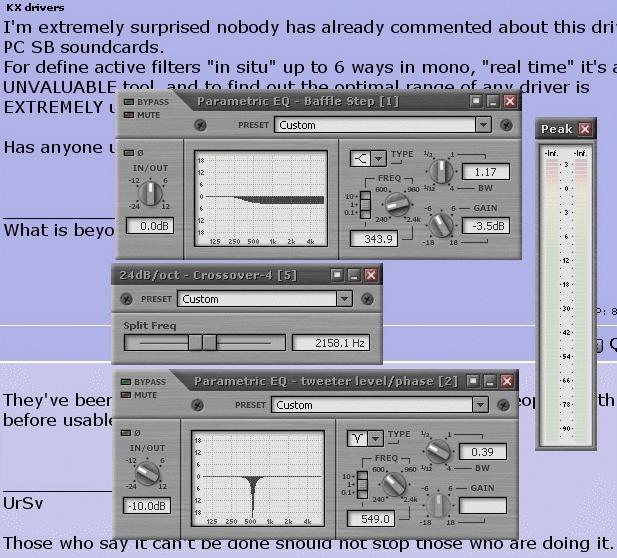

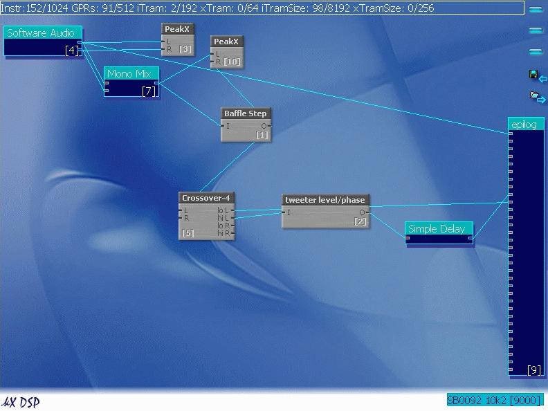

Here's a look at one of my dsp setups...
And the forum top is here - http://www.driverheaven.net/forumdisplay.php?f=67

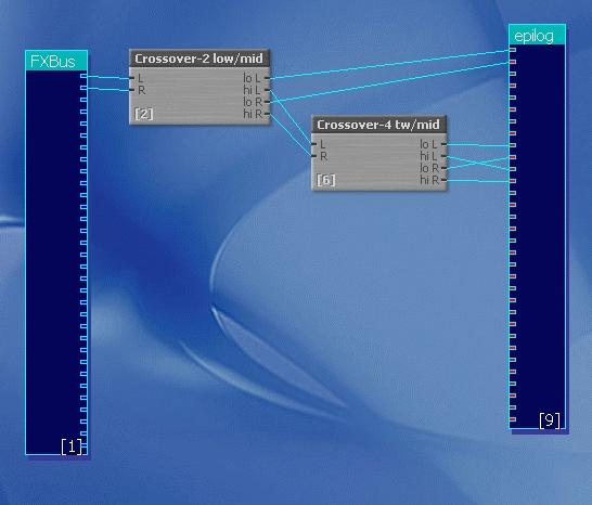

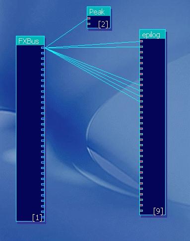

Might be best to ask the kx forum at driverheaven.net to help with this, but here is a test setup that you can try with a full-range speaker or headphones to check if all outputs are functioning. Also go to the master section of the kx interface (double click in the tray icon) and uncheck 'toggle swap front rear mode'.
