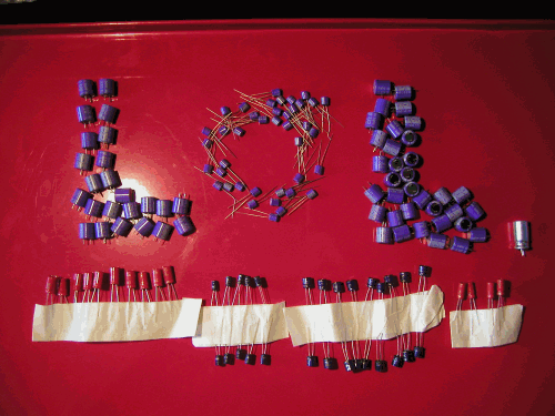

Hi Rudolf,
Looks like a naturist beach to me!
As if taking your cloths off will change you.......
rbroer said:Just for Elso,
Hi Rudolf,
LOL
Rudolf,
Are my eyes playing tricks on me, or do I read the characters LOL in your picture of the caps?
Rudolf,
Aaaah, so many sexy caps! How am I supposed to work when I am distracted by these pictures in my browser...
