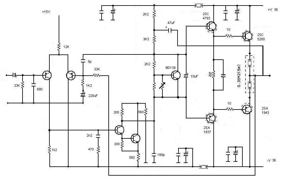

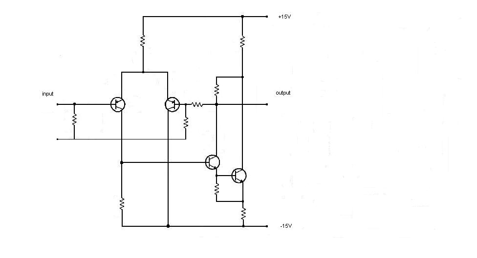

A problem with the Kulish stage (as far as I found in my little investigation so far) is that it seems to need a high supply voltage, at least if one wants to make use of the most linear part of the transfer function which is at the lower end of output voltage (see my post in LXG's Kulish thread). This might complicate its use as a VAS, like in your first ciruit.
While in general these ideas look promising one still needs to elaborate on them in depth to see if the advantages really win over the disadvantages...
Klaus

It has certain advantages if your topology allows you to keep the inner collector swings limited, and keep both transistors comfortably biased in a linear region with a reasonable amount of Vce (more than a few volts). For a classic VAS, with large collector rail-to-rail voltage swings, this can be difficult, unless a additional pair of higher voltage rails are employed. My suggestion is to leave the VAS as a single-ended or cascoded BJT, and think about an LTP instead.
I haven't looked at the LTP biasing in detail yet. It should be possible to develop a Kulish LTP that is in effect a JFET replacement, and even more linear and more flexible wrt to transconductance adjustments, etc.

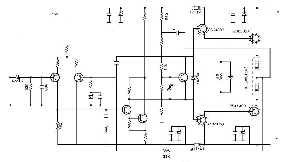

Hi Guillermo,
Did you ever build your last design?
That was a nice amp, you should build and listen to it, it will definitely surprise you.....
I mention this because you are falling into the same trap which gets me every time; moving from one idea to the next without fully investigating the last (good) idea......
Hugh

Hugh makes a good point... as I suffer from this phenomenon, too. Common availibility of simulation tools makes this even more dangerous -- new day, new set of ideas which "have to tried first before making a final decision" (repeat ad nauseum).
