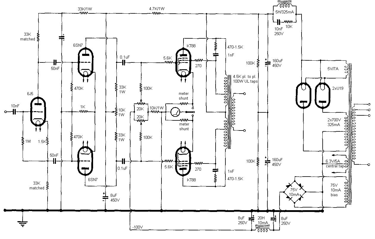

I'm looking to build a simple 100W amp with readily available tubes. I came across the GEC KT88 100W ultralinear schematic which seems reasonable to my untrained eye, but I don't know about the transformers. I'll probably have to sub for the 6J5 and U19 (2x5R4WGB?). Also, I was looking at the hammond 1650RA and 373HX and I was wondering what others were using and if there were any issues with this particular design or perhaps suggestions for others.

I think you won't get that output/CH with todays new production without burning up a lot of tubes early. The new KT-120 or coming KT-150 would be a better tube or even PPP circuits with still those big tubes might be the most reliable.

Beat the snot out of tubes and their service lives will be short. There's little reason to believe OS tubes were any different.
If this is a musical instrument amp, KT120s will be good. OTOH, the pentode mode plate curves for the type are hideous. The KT120 has serious linearity problems. Its distortion products may be euphonic, but that's not HIFI. I don't like bludgeoning a circuit with NFB to achieve respectable linearity. IMO, you start with something reasonably linear, from the very beginning. Then, a small amount of NFB to clean things up and increase damping factor finishes the job.
A reliable 100 WPC HIFI amp may be possible using PP KT88s. Take advantage of the type's rating for positive control grid current and build a Class "AB2" setup. Tubelab's PowerDrive will be needed between the phase splitter and the "finals".

Modern Production KT88's can not handle 100K on the grids if you want a long life with Fixed bias.

I fully agree with what's been said already. 100W with just 2 KT88s is pushing it. Specially with todays tubes. For home audio, I'd settle for less wattage (100W is loud!) which makes for an easier build as well and reduces the number of tubes you go through in a year 😛
Edit: I'd loose the pot to balance the PI as well. That's a lot of DC going through that thing!
Edit2: I assume there's a preamp going in front of it. I've not done the calculations, but it seems impossible to drive it to full output with a line level signal.
Edit3: And the meter is nice, but adds complexity. Nothing a DMM can't do (better).
Drop B+, run it around 70W. About 1 dB quieter, and your tubes will last years (decades) instead of months. How efficient are your speakers?

GEc KT88
the circuit I submitted is missing the voltage amp; you need to use a 6SN7 instead of the 6J5 shown; the voltage amp direct coupled to the Phase splitter.
I use 12BH7's or the Russian 6N6 instead of the 6SN7's much better drive.
A circuit for a 70 watt amp.

Use a 1650TA Hammond and four KT88's in push pull parallel for 100 - 120 watts. Two KT88's are not going to give you an honest continuous commercial rating of 100 watts in anything near class A, AB1, or even AB2 if you run the tubes within their normal range. Sure some will beg to differ with me on that. This is just from real world experience in hifi and guitar amps using this tube.

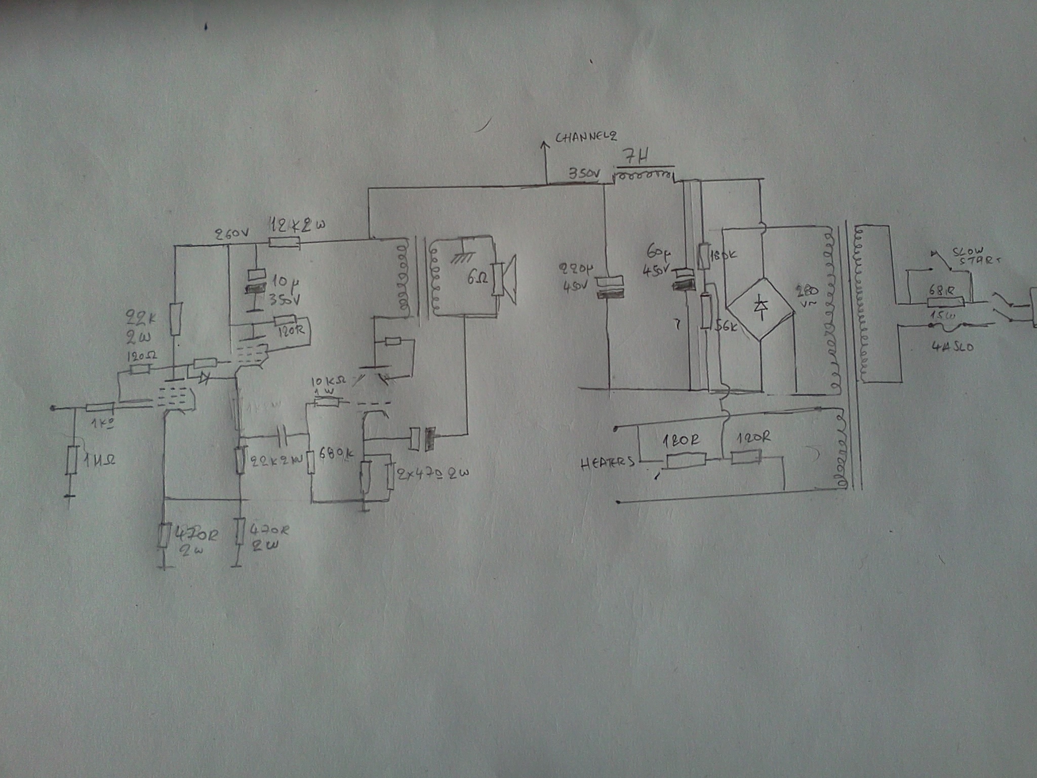

here's a schematic with cathode feedback...I am currently rebuilding

Here is another
