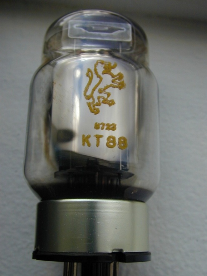

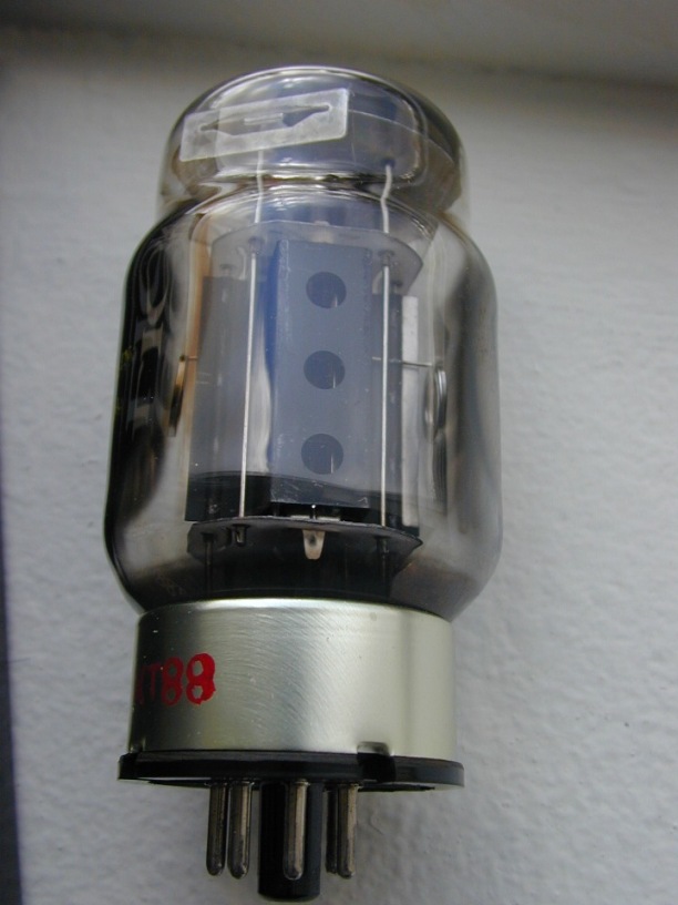

Not to thread hijack, but I have about 9-10 (3 matched prs and a few extras) of these Chinese KT88's. Are they older production or newer garbage?

Date code indicates 23 week of 1987, so these are older production "Golden Dragon." (PM Components?? IIRC) I am unfortunately quite familiar with these, and while they sound quite good, reliable is not a word I would use in conjunction with them. Best used at voltages not much higher than 400V and may 60mA plate current. I repaired more than a few ARC (M100) amplifiers after these tubes blew up in them.

Kevin: Thanks for the info! I suppose you could have said "the only thing reliable about them is their unreliability". 😀 They came in Red/Black Gold Lion Boxes. I've run a couple in my Quicksilver Mini Mites and thought they sounded quite good, although I prefer EL34's in the Quickies.
I recently picked up a nice used quad of the Genelex Gold Lion Reissues, so I am planning on selling these tubes for cheap if folks want to use them for amp testing, etc.

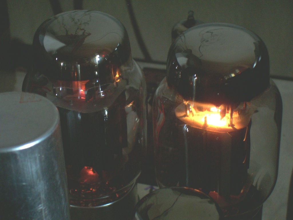

About a year ago, I purchased a matched pair of JJ KT88s from Triode Electronics. About two weeks ago, I noticed the inside of one tube glowing brilliant white. Looking inside more closely, the grids were glowing white. I swapped the tube positions, and the problem moved ... so I know the tube is suspect.
Grid bias set for cathode at 1 volt. Basically a stock amp but with the filter cap board upgrade from Triode and a silicon diode replacing the selenium. All PS voltages are at spec.
How often do JJ KT88 tubes have this kind of failure? I wrote to Triode but do not have a reply yet.
I did not physically remove the ancient can electrolytic in-view. But, it's disconnected.
