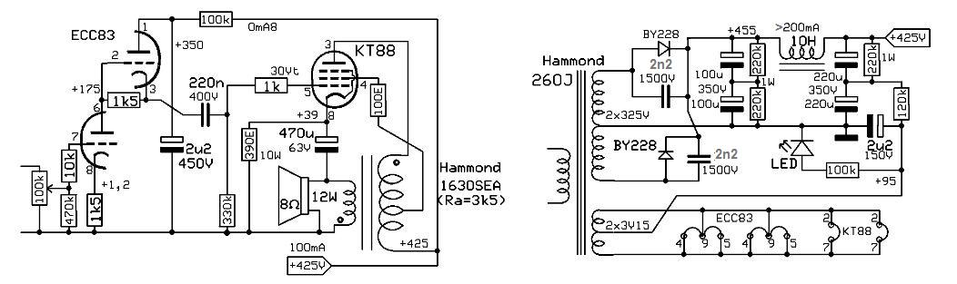

Hello, Community. I've already successfully built my first tube amp (SE 6n2p (12AX7) + EL84) and transistor amp (Beta22). Now i'd like to advance myself in tube amplifier for speakers as Beta22 is more suitable for headphones. Now i'm looking for good schematic in order to build SE amp (hi-fi) with the following parameters: up to 6-10 Watts per channel, KT88 or EL34 tubes, ultralinear application.
I built the PA part of this and really like it. Very open. The PA part is the 6CG7 and KT88. Pretty low sensitivity so needs a preamp with decent gain or use higher mu input tube.
R18 was put in to raise Zout of the 6CG7. Removing would no doubt increase sensitivity.

thank you for your comment but it looks like that 6CG7 is very hard to get in a brand-new condition. And i'd like to find a solid finished schematic without any need in redesigning

The 6CG7/6FQ7 is in production. At a minimum, New Sensor offers the tube under the ElectroHarmonix (EH) brand and it's available with or without gold plated pins. 😉

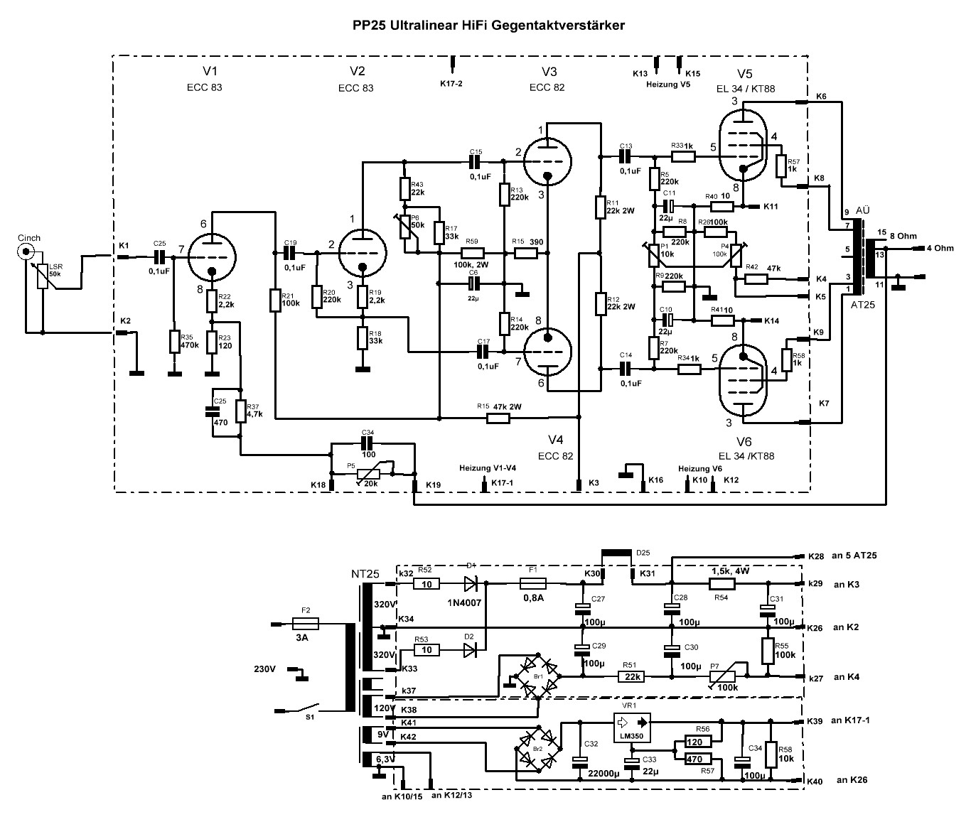

Ultralinear PP KT88 45W
Hi.
Do you have more information about the circuit?
Ok, I found it - AmpDesign.
Regards

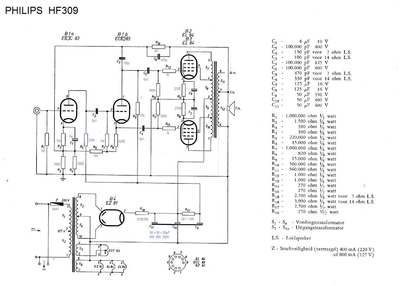

How about this one 😎Interesting circuit. And how about el84 in push-pull?

The Dynaco ST-35 is a well known and liked EL84/6BQ5 PP circuit and it is UL.
There is a another recent version of it on the diytube site that breaks up the 7247 into (which the 7247 is internally) 12AX7 & 12AU7 for more tube subbing as 12BH7 can replace the 12AU7.
Some have made P2P (point to point wiring) amps of either circuit. They can be seen on the diytube site.

It's pretty hard to build a bad sounding circuit wize El84/6BQ5 PP amp so they say, and in my experiences the quality (re sonics) of the Output Transformers used are the biggest issue.
