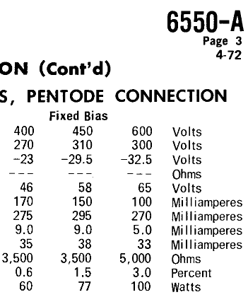

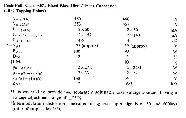

I've always considered the 6550 the same as a KT88 but you're right. I'm running the tubes as shown in the sheet snippet l posted in the last post on 6550 in UL. It's worked fine for over a year now so I don't think it's an issue.
FWIW, I use a Hammond 278CX with cap input to power it. B+ is about 560V at the plates, and 50V at the cathodes for 510V @ 83mA, 42W Pd per tube. Fixed bias would get me 30% more power and the Pd would be closer to 25W per tube (at idle).
I think modern 6550A and KT88 may well be the same thing after all why have two different production runs when one will do. I am UL and servo bias and get 120W rms per channel with a 372LX transformer and 1650T OPT . Very pleased but wanted to try something else. Still not understanding why a KT120 needs so much bias when a 6550A does not. This is simulation for the KT120 - I don't have any.
