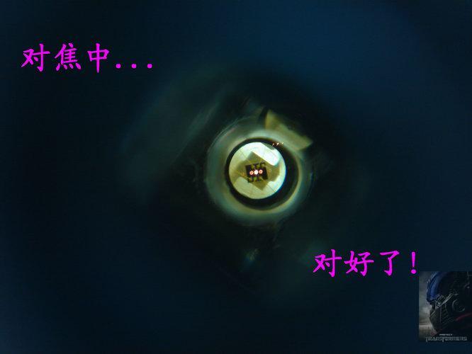

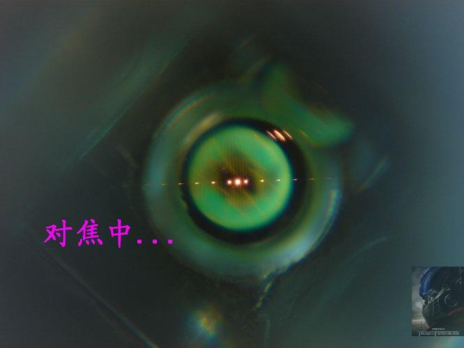

There are some photos floating arond by laser repairers
What struck me was the fact that one can see the beam spots
superimposed over the photodiode-array spots.
Maybe this effect can be used for aligning?
See photos below:

Tried to contact Ken Klements for my laser diode swap project.
See photos below:
Hello. No, in fact, I doubt that in reality, the laser impact in the photodiode array be like in this picture.
If you see, almost all laser pickups has a part when you can see the A-B-C-D-E-F diodes. This makes me think that the method used in factory for to adjst the laser diodes is with a machine reading the A...F diodes. To adjust it, you have to put a mirror front the pickup, and to excite the focus coil with low frequency signal and a bit of dc voltage.
When you are triying to adjust the laser, you see that the first diodes to reach signal are E and F, then the others. Find E-F is easy, to calibrate A-B-C-D diodes is the most difficult. So, when you are triying to find the best position, you make a mental representation of how the laser are lighning the photodiodes. So, that makes me think that this pictures is a artistic representation, I don't think it be true in reality. E-F.
I hope another technician or engineers trying to do the same like I, so with more experiences, we can reach more knowledge in this issue.
In the manual service of the Pioneer P-D70 appears how to adjust the laser pickup, with an oscilloscope and a external device, this manual is the key.
See photos below:
Though I had a lens for to see the laser beam like this picture, I have insufficient definition for to center de beam at the a-b-c-d photodiode cell. The center beam must be centered with 25% of the beam in each photodiode.
This makes me think that this pictures are not real, it looks to me a artistic draw or similar.
