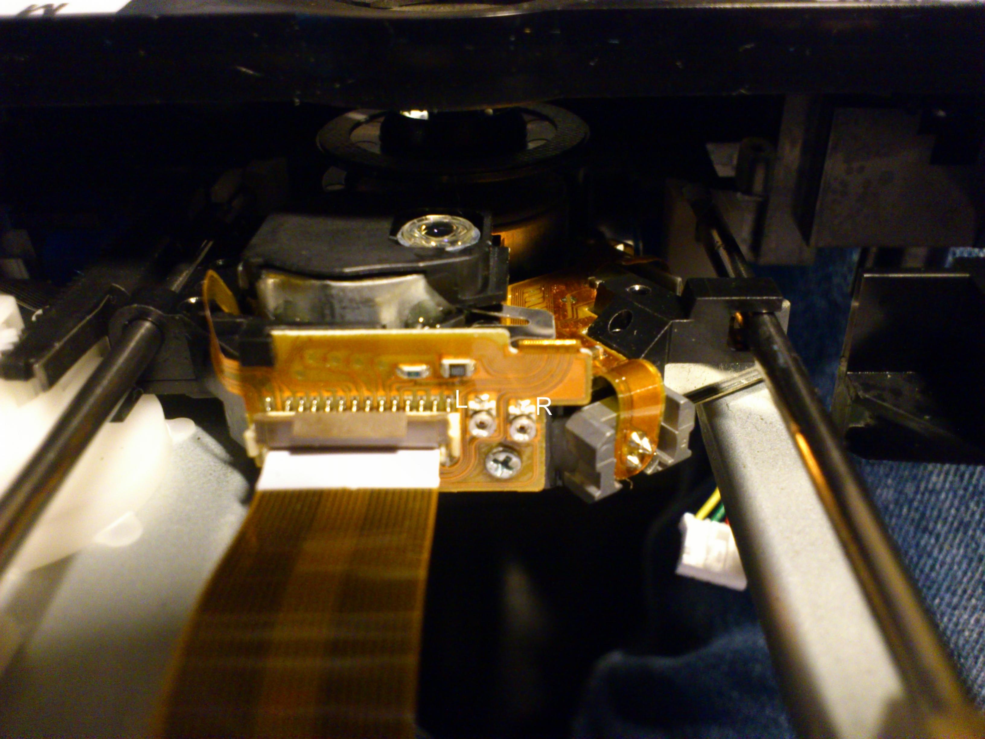

Need some help getting my SACD back to working conditions.
It has stopped reading any CDs or SACD.
I can hear it spins Up(Display shows READ) for a short period then stops starts over and same stop again.After approx 15-20sec it opens CD tray.
Were am i? Laserreplacement or any adjustment?
Lens is cleaned from dust.
Hope for some helpful hints.
Added Info
Left Pot measures 348 Ohm
Right Pot measures 998 Ohm.
hard to say. In case of players for cd only I would replace only the laser head. But in players compatible to SACD mode the RPM value is much more higher (similar like DVD).
As a result, the spindle motor could be damaged more and in this case I would rather replace the mechanism (the spindle motor as single part isn't available as I know).

I know this is an Old post but thought I would share some info for those who have Krell Mark III's. Over last 12 years have used this player very extensively. Lately it started getting real fussy and having hard time reading SACD layers on Hybrid discs or not recognizing discs at all and having to fight with it. Purchased a Raymedia laser head unit went to 100% not working. Out of frustration starting comparing old head with new head. There was a solder blob that connected 3 pads on the PCB. It looked like been removed on original that was in the Krell. So I removed that blob with my solder sucker and bingo!! now my Krell Mark III works like a brand new unit.

Static protection? Huh... well I guess that makes sense. Wish I knew about that or there was a note with the part. I spent like 2 hours trying to figure out why the SADCD player was not working. Also on the original laser unit there was also some cut traces and missing a surface mount part. I left that issue alone, on the new part. I purchased the laser unit on ebay. There is a couple of people selling replacement units. Just do a search for RL-S881
