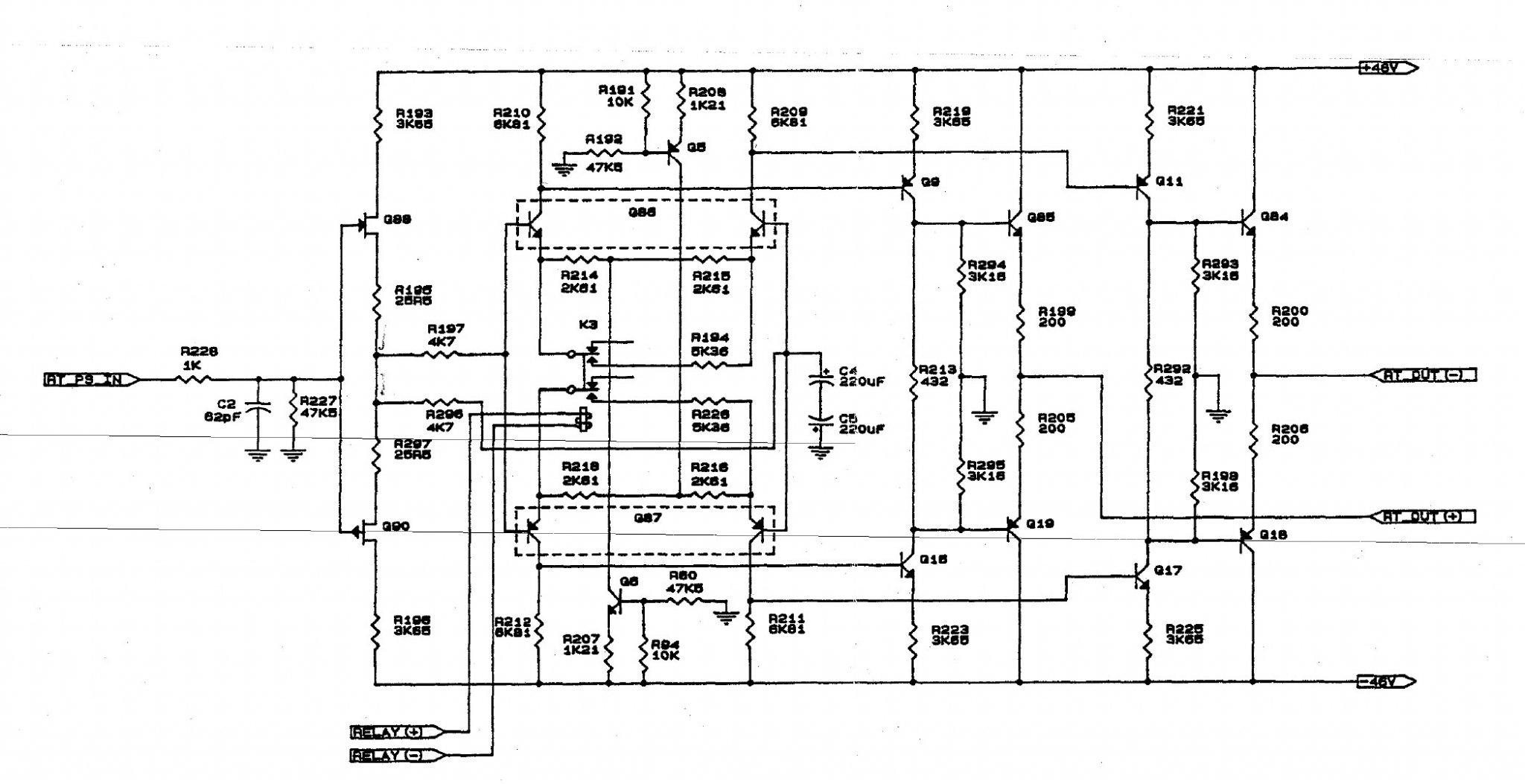

Some progress to report. Per your encouragement I tried to actually diagnose the problem. I don't entirely know what I'm doing so any comments on the approach & thought process would be welcome - I'm trying to get better with this stuff. Here goes.
The schematic is the right channel phase splitter. The outputs go on to feed other stuff (not shown). First, it was suggested that the imbalance problem might arise from old, failed relay(s) so I replaced them (K3 below). Didn't help so I tried to figure it out better. A 1khz sine wave was fed to the preamp from a signal generator. I worked my way down the signal path from the preamp outputs with a scope to compare the signals on the respective channels. In hindsight I should have done it from the input side. It turned out that the imbalance went all the way back to Q90 which turned out to be shorted (Gate <-> Drain). How/why would this happen?? No idea, but it was.
I got replacements on order. Now more questions arise. I also ordered replacements for Q88 on the theory that replacing both phases would be a good idea cause of aging and so maybe better matching. And then, if they're replaced on one channel, why not do the other channel as well to try to keep things more matched on both side??
So, does this make sense? Anything else I ought to be thinking about? All the comments have been very helpful so bring it on! Thanks and cheers,

FET's are tricky to test with the diode test of a digital multimeter. Google the right procedure.
If Q90 is indeed defective, you will have to replace it. Success!
Well, as sure I can be. I did google the right procedure. I also pulled the corresponding JFET from the good channel to compare. I know, one is P-channel and the other is N-. I took that into account and Q90 really does seem to be shorted. But the proof will be in the pudding and revealed when replacements arrive. Is there much likelihood that Q90 shorting would take something else out with it?Are you sure Q90 is defective?

I actually did repair the KBL, just forgot to post, too much going on. Anyway, it really was Q90. I replaced that, it's companion on the other side of the circuit as well as their fellows on the other channel just for good measure. Also recapped the whole thing. The problem was fixed and it sounds as good as it ever has. As for the volume control, it seems fine. No noise thus far, thank good! Thanks to all and cheers,
