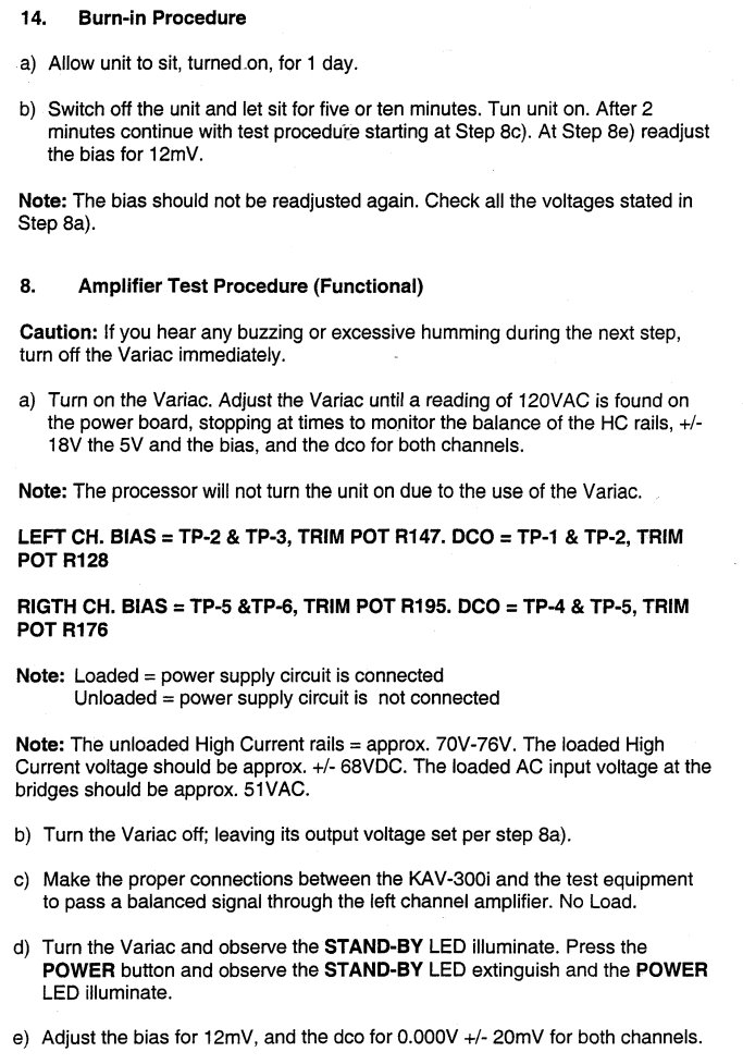

Biasing and offset info in att image.
Read it CAREFULLY as its a bit different to most amplifiers I have worked on.
Basics.
Let the amp run for at least a few hours.
Turn it off for 5-10 minutes.
Turn it on.
Wait 2 minutes.
Adjust bias to 12mv.
Adjust offset for 0.0 (< 20mv)
Do not readjust further.
I followed this to the letter.
But I also then let it run for several more hours and went through this same procedure again just to make sure.
I didn't need to. It was exactly right.

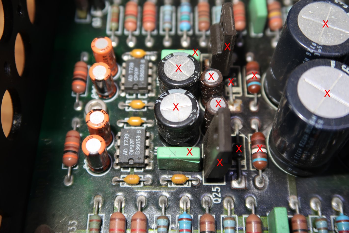

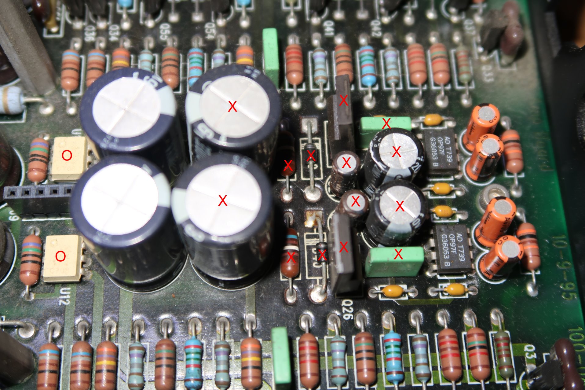

A friend gave me his KAV-300i to repair.
Fault was 'one channel was fuzzy irrespective of input or speaker'.
Examination revealed main filter caps were bulging.
In the middle of the amplifier board, under the input board, I found several other parts heat damaged.
I also found an opto coupler was faulty. This is directly in the biasing circuit. (U12 U15 - cny17-2)
As well as doing a complete re-cap, The following were heat affect and replaced.
Resistors R43 R44
Diodes D39 D40
Film caps C43 C45
Electrolytics C62 C63 C78 C79 C44 C48 C21 C46
Transistors Q25 Q26

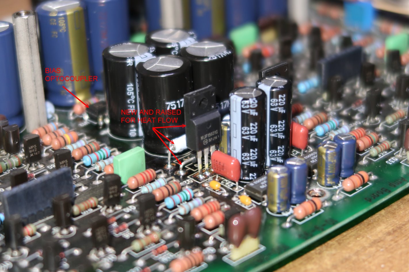

Edit.
pic 1+2 heat affected area.
Different angles of the same area.
The resistors are 6.19kohm ~1.5w, they measured 6.36ish, replaced with 6.2k 2w panasonics raised up a few mm for heat dissipation.

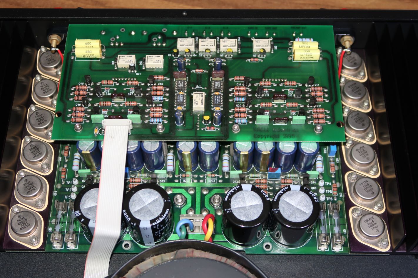

pic 3 after repairs.
Also replaced the two diodes and transistors purely so i had fresh full length legs to enable me to also raise them off the board.

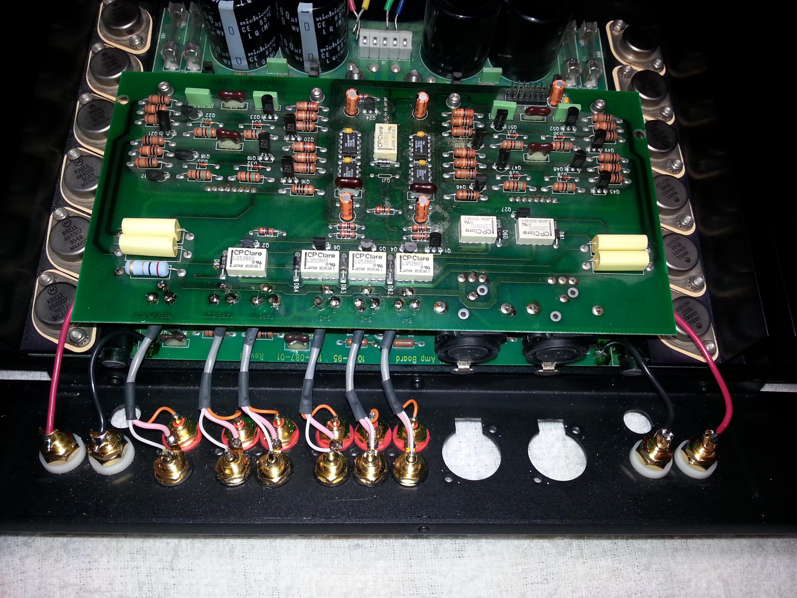

Old N Cranky, you wouldnt by chance still have the part numbers to the caps that were replaced?
I just acquired a factory stock version 1 of the same amplifier and decided to replace all those abysmal RCA connectors with some nice Neutrik units, replaced the nearly as bad binding posts with Cardas CCGGS.
Although the amp still sounds very good, I noticed one of the filter caps bulging a little so some preventive maintenance would be a good idea. I may as well replace others while I`m in there.
Hi Michael.
Exact part numbers no. Depends on where you buy them I guess 🙂
Front to back. What I used;
The four main caps Nichicon 6,800uF 80V 85deg 10mm snap in.
The ten behind those are Panasonic fc 330uF 100v 105deg.
Watch hight with top top board.
Also on this one theres a cap hung under the top board near the left connector.
I had to lay this over to miss the new fc's.
Four in the middle of the board Panasonic fr's 3,300uF 25v.
Two resistors, panasonic 6.2Kohm 2w - Replaced so I could raise them off the board for air flow.
Two zeners 18v 1w (1n4746) - Replaced so I could raise them off the board for air flow.
Two optos cny-17-2 - Bias, one was dead, cheap, do both, opto's go off with age.
Two panasonic fc 10uF 63v
Two tall ones panasonic fr 220uF 63v
Four at back of board panasonic fc 10uF 100V
Under main board four AXIALS Nichicon 47uF 100v - These are what was there, and the only ones I found that would fit. Super tight squeeze.
Few more caps on top board.
Overall nothing critical, I just used decent parts. Should last another ? 20 years.
Latest report from owner is the parts have settled down (broken in) and it has never sounded this good. 🙂
I guess if you wanted to use silmics, have at it.
If it was mine i'd also upgrade the four yellow nasties at the back of the top board. (inputs)
But you'll be fighting for space...
EDIT.
I'd suggest pulling yours apart, and make a list (with dimensions) of what is on your board.
Might be different to this one ???
Also, when you put the top board back in, be VERY careful of the two sets of joining pin/sockets.
Make absolutely sure they are pin for pin lined up and connected straight.
