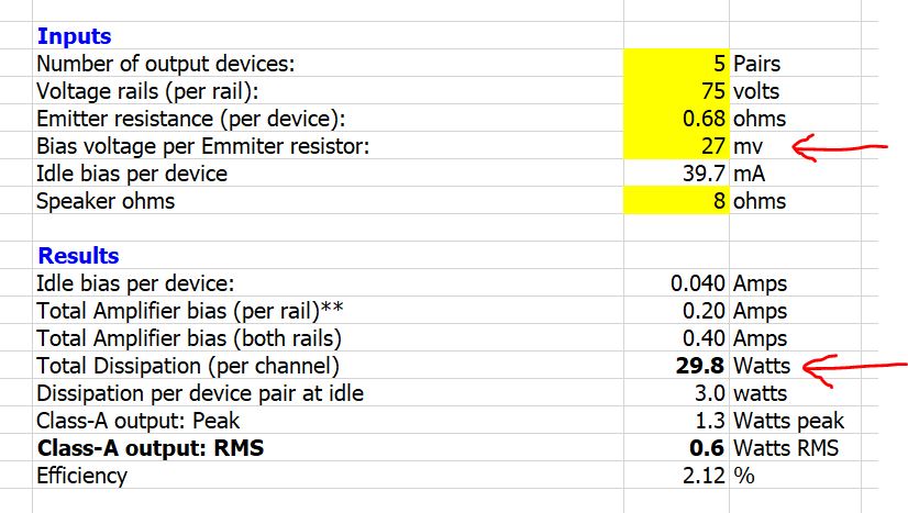

Attached is the Schematic I got from the OP:
Running some calcs based on the spreadsheet and the following parameters: (confirms analog_sa's numbers)
40 watts consumption during warm-up ie about 15 watts dissipation per channel (plus 10 in other parts of the amp) requires about 15mV across each 0.68 ohm ER (or 19mA).
Once warmed up, the amp idles at about 80w (about 30w per channel assuming 20 watts in other parts of the amp) and to get to 30w dissipation, the current per device is about 40mA or 27.5mV across the ER. This gives the amp a little less than 1 watt pure class-A operation.
So I'd set it at 15mV and monitor the temperature and voltage drift. Fully warmed it should be about 27.5mV. The sinks are small on this amp, so I'd say it will idle between 45C to 55C based on past experiences. If it goes higher, check each device and make sure they are all about the same temperature and if they are, reduce the bias till you peak to around 50C.

These are the numbers you want to be at warmed up with NO signal and NO speakers connected after about 40 minutes.
Hope this helps.
I set one channel bias to 15mV, and bias remains stable, seems do not changed with temp go high.

Unlike Krell's well known big amps with sustained plateau bias, the small guys run at fixed bias. This one too. And as every class AB amp it works in class A up to some level. K-amps has been kind enough to even calculate it.
So the 15mV heatsink become 51C degrees, on some points a cannot hold hand more than 7 seconds.
Can you measure the power drawn from the mains? It is the best indication that the idling is correct.
Can you also confirm that the emitter resistors in the amp are indeed 0.68ohm as indicated on the circuit? It is not unusual that production amps use different emitter resistors and this will of course change the target voltage.
